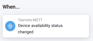

any idea why this event is triggered twice eg. when linked to notification to mobile ?

I will take a look. It is possible that I broke some checks in latest version.

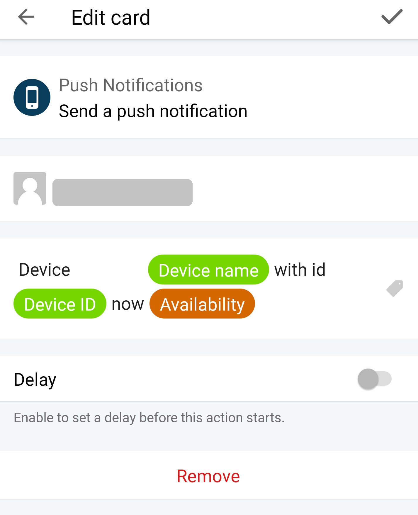

I checked and it worked OK. Can you, please, configure your action flow card like this:
So you will get a notification with device name, id, and availability status, like this:
Maybe then we will be able to see where problem is.
Pavlo I actually upgraded yesterday to latest Tasmota 9.2.0.6 and so far I’m not getting double notifications. It’s odd that since certain Tasmota version the “ping” command seems to be failing more often compared to previous versions (and I assume also “mqtt” availability as such then).
So maybe it’s not problem of your app after all…
Not sure what is going on if Tasmota is actually very close to router (but I have that problem on all my Tasmotas)
obrazek
It could also be that ping responses just aren’t given a high priority in the network stack.
In the application, there is a direct check to trigger events only if availability changed. So if you have a double event it is possible that the device became unavailable and then immediately available again.
