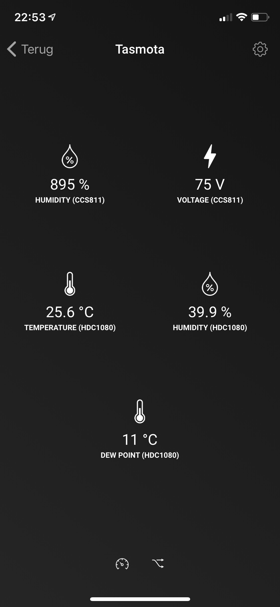

UPDATE:
I have compiled a new Tasmota version. In this version I have changed the headers of the CSS811 sensor:
eCO2 => HUMIDITY
TVOC => VOLTAGE
As you can see in the screenshot below the problem is solved due to the fact that the Tasmota app does not recognize the headers: eCO2 & TVOC.
Can you please add these headers to the Tasmota app?

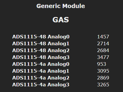

Hi Pavlo
Can you please have the app understand this MQTT?
its a bunch of analog values :slight_smile:
18:11:55 MQT: tele/tasmota_02386F/SENSOR = {“Time”:“2021-02-09T18:11:55”,“ADS1115-48”:{“A0”:1472,“A1”:2719,“A2”:2680,“A3”:3754},“ADS1115-4a”:{“A0”:967,“A1”:3243,“A2”:2997,“A3”:3153}}

@Stefan_Wempe it will require some work and I really want to finish shutters support so I will add this not in the next but following release.
no problem, got it working through homeassistant → homey for now :slight_smile:
