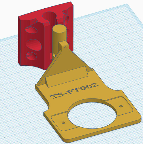

Btw, in case you are looking for some mount options, I have created one - PrusaPrinters (3D Print)
Wow, that is pretty cool! Is it not mounted too close to the tank wall?
Thank you. It’s like 8cm…still waiting for warmer weather to see if it’s ok or not :wink: When testing it on solid surface close to the wall, seems it still measures fine…I believe the key is to be fully 100% horizontal.

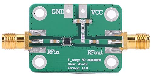

Maybe it works with a signal boost or a new (larger) antenna at the sensor? For me it’s not an option to open homey. Or is it possible the extend the antenna with a cable so it can be placed outside of the tank an closer to homey? @Undertaker ???
Why not to replace the antenna directly on TS-FT002 ? Eg. using 5pcs lot 433 MHz Antenna 5dBi SMA Male Connector 433m folding antena 433 mhz waterproof directional antenne for Lorawan Gasmeter|antenna uhf|antenna moduleantenna dbi - AliExpress… in case I will have issues with reception, I might even get the antena out, eg. using 5dbi 433Mhz Antenna 433 MHz antena GSM SMA Male Connector with Magnetic base for Ham Radio Signal Booster Wireless Repeater|Communications Antennas| - AliExpress
obrazek obrazek
that is what i mean. this will work?
If you don’t dare to open Homey, you can mod the sensor yourself. There are 433 Mhz amplifier modules that are looped between the antenna. I don’t know the sensor though. Someone would have to open it up to see where the antenna is and if you can solder a pigtail on.
Please check, however, whether such a performance increase is legal in your country.
Edit: Just saw the photo. A mod should be easy.
The original antenna can remain in the housing. Simply solder the pigtail to the base of the antenna. Perhaps there is even space in the housing to accommodate the amplifier.

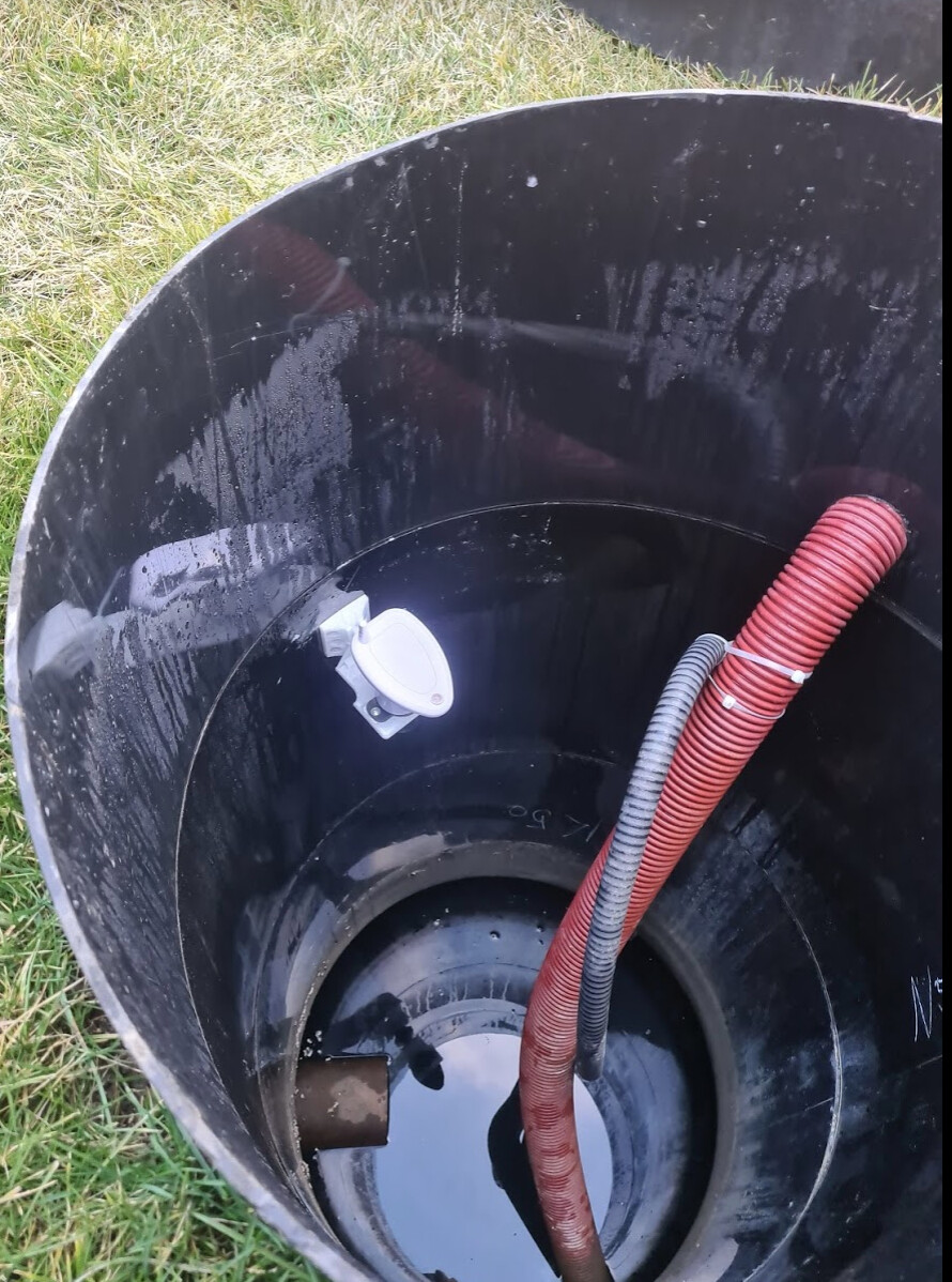

So I installed TS-FT002 like on the picture. Signal seems to be fine (the tank has cover and then it"s approx. 10m from the Homey behind one triple glass).
I measured the air gap and the depth, set it in the app, the air gap was 90 cm, yet app showed 99cm in measured values - so I changed it to 99cm, after a while it showed 100cm, so I updated it to 100cm - it stabilized now … because the tank is full now and it would not report full without this adjustment.
Not sure how it will work as it’s located quite close to the wall (yet full state is reported fine), I will then eventually adjust my holder, however is it correct what I did with adjusting the params ?
Why it is required even to set this parameter if the app is able to “measure” it ? Or I got it wrong :wink:
Wow, very nice @Sharkys ! That is a big tank. What is it for? Is the photo showing max filled or empty?
You have to tell the app what the dimensions of your tank are, otherwise it cannot calculate the fill % and the m3. So you need to set the max level (100cm gap in your case), the min level (how deep can the level sink in your case?), and the liters that are contained when full.
It can vary by 1 or 2 cm. I think it is caused by speed of sound depending on temperature, humidity and air pressure.
It’s rain retention tank, just 4m3, not a big one :wink: It’s showing full, the air gap is 90cm (100cm) and the maximum depth is 230cm, that’s what I also set in the app. Now I need to wait for spring/summer and start irrigating garden :wink:
Ups, my mistake, it’s measured 90cm, it showed 99cm and then 100cm… but even 9-10cm is fine for me. I was just wondering as your app somehow calculated it by itself, if you know what I mean :wink: So I set it in the app also to 99/100cm…
That number is measured and reported to Homey by the sensor. I would say it is the distance between the water level and the ultrasonic transceiver in the unit.
