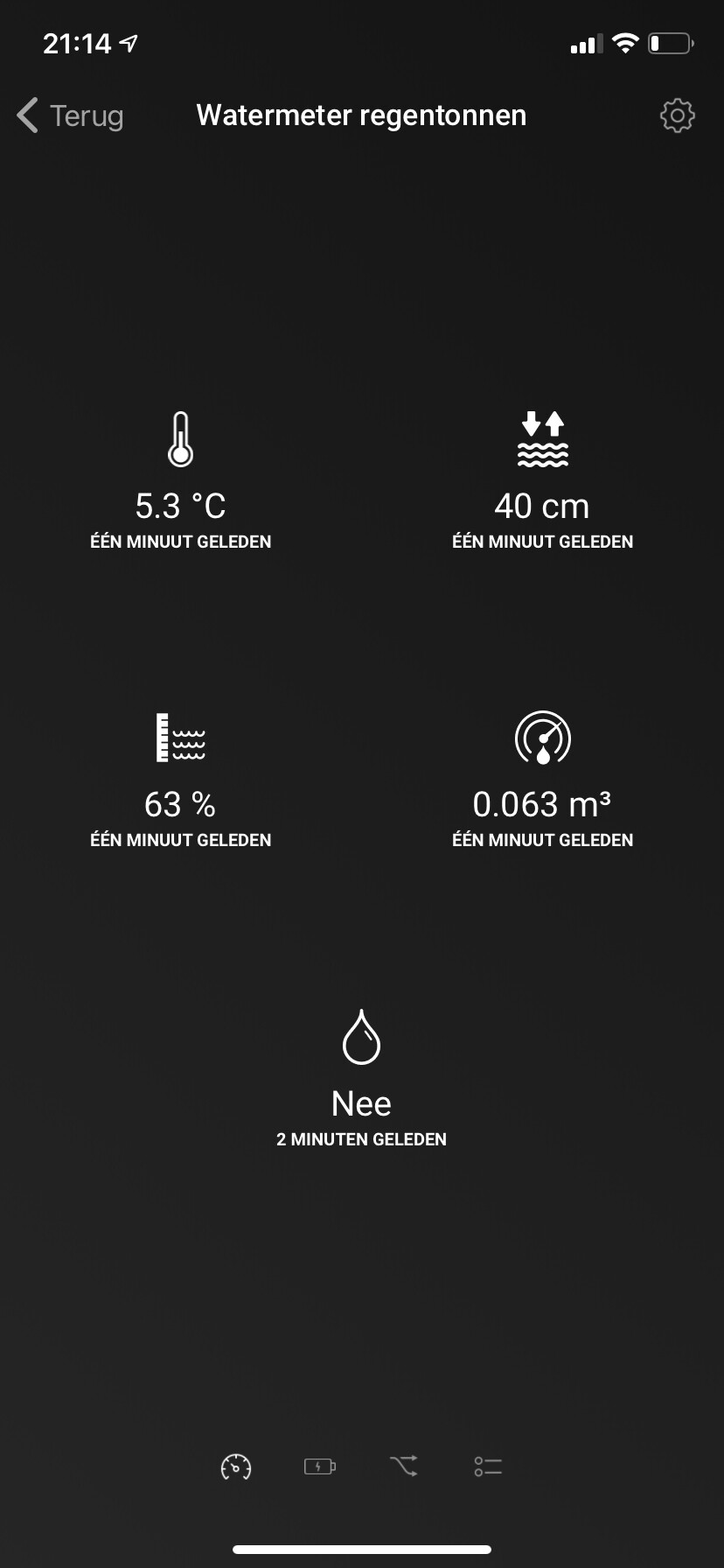

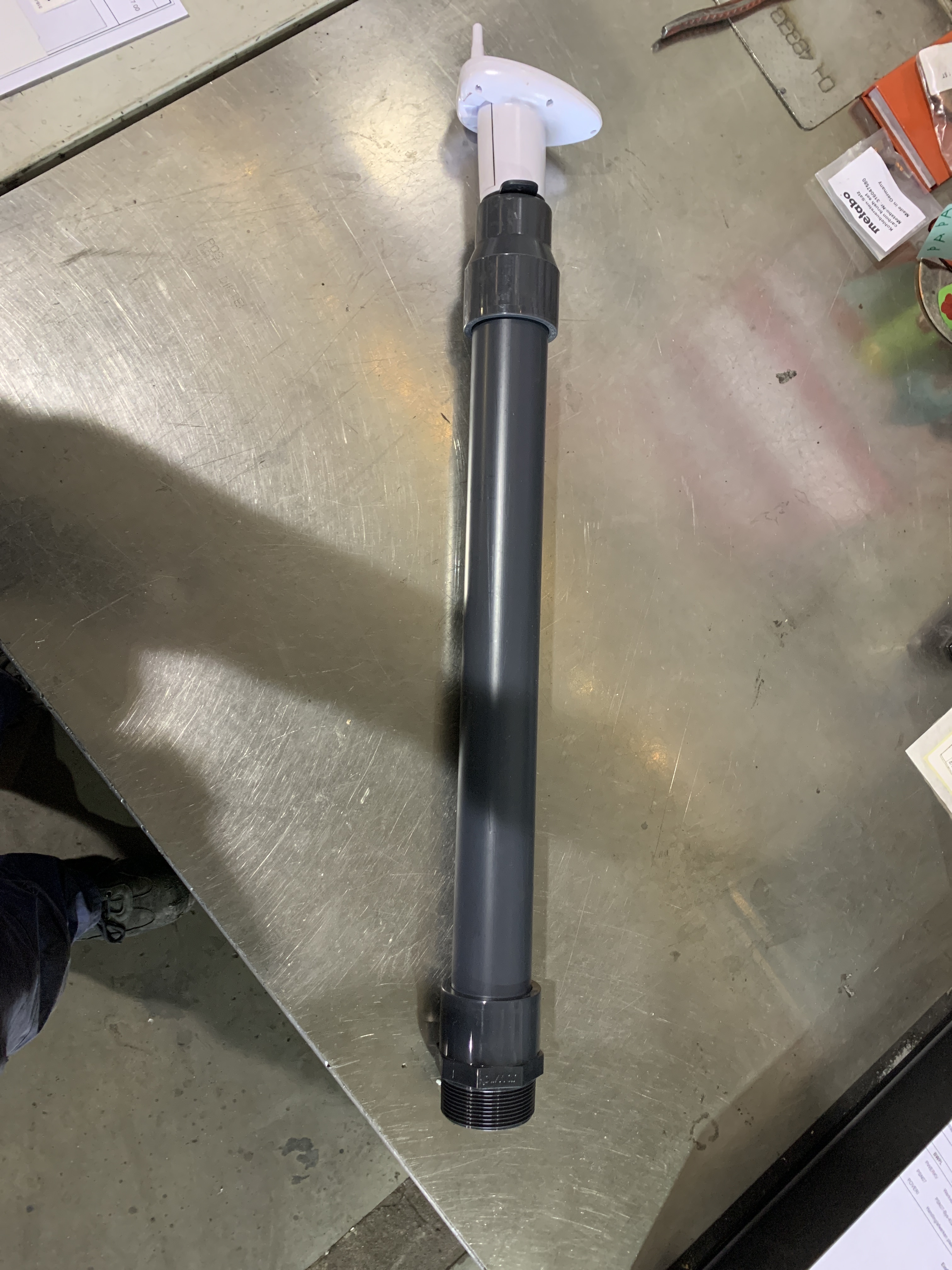

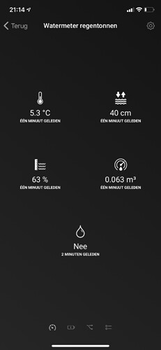

I am doing something wrong rain barrel is 93.5 high water reaches 82cm
space between the sensor is 8cm, that for me too, the barrel is also max full but it still only indicates 63% full Zie pictures for info maybe you can. Help me
Minimum distance the sensor can detect reliably is around 40 cm. That is your issue. So place the sensor higher, or accept that you will not be able to see reliably if the barrel is more then half full.
Can we than make a pvc pipe its that oké? For the working
thank you for the help I am going to work with it I am already very happy and certainly done well with the app develo
