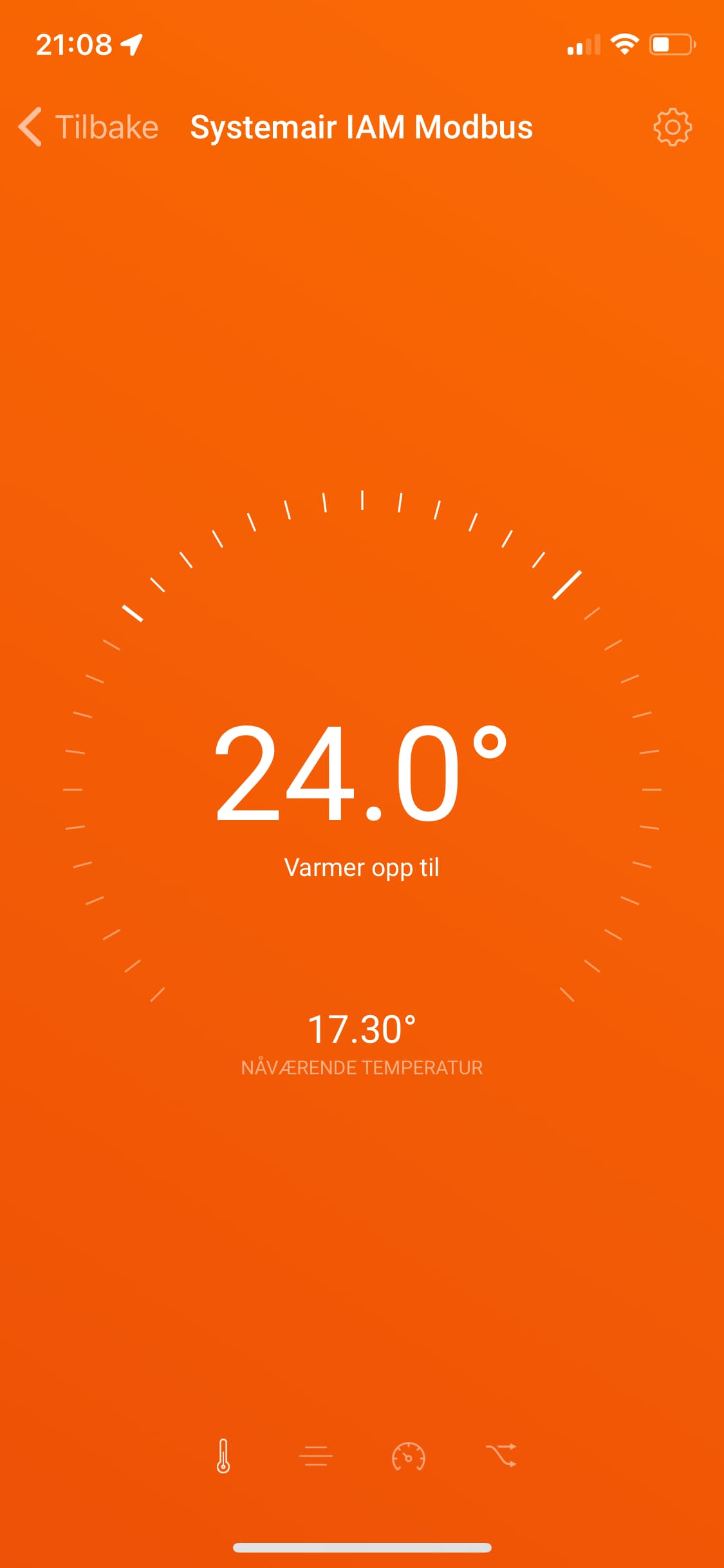

I regulate the temperature in systemair from the extract air temperature.
In your App the intake temperature is the value shown.
Possible to fix this? Unless the thermostat will always be ON (heating) in my case.
Extract air normally 24C
Intake 14C
Will add something in settings to support this.

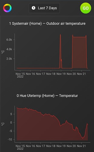

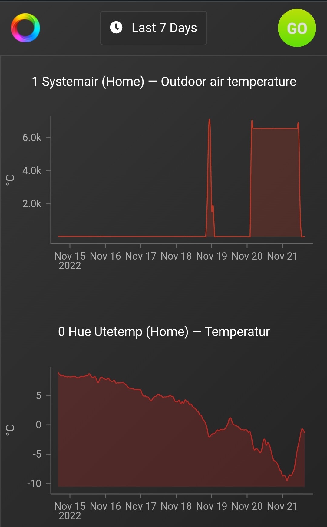

There seems to be an issue with the outdoortemp when it’s below 0°C.
It shows from 6549 to 6553 °C when the outdoor temp is aprox. - 8 to -0.1°C
Is it a known problem?
