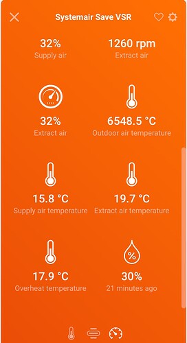

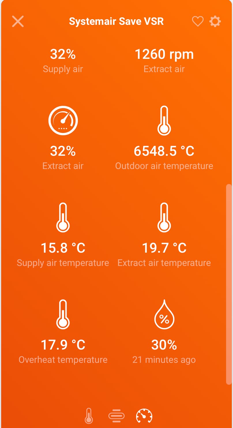

I use the outdoor temperature from the my Systemair unit to update a virtual temperature device and with the cold weather I discovered a potential issue with how negative temperature variables are handled in the Systemair app.
As soon as the outdoor temperature becomes negative the value in the device jumps to 6553.6 C. If the variable is a 16bit integer scaled for display with a factor of 0.1 I assume that bit 16 is the sign bit. So after updating the flow which sets the virtual device to deduct (2^16)/10 from the value from the SystemAir device my virtual device displays correctly for negative temperature values
Could you check and possibly fix in the next release?
(Note: this issue was not pressent with the cloud Interface)
I too am experiencing incorrect values on outdoor air temperature with negative temperatures. I also previously used the cloud interface before it was broken by systemair and had no such problems then.

Same here, I do not use the temperature for the moment, but display 6553 degrees in my system when in real the temperature is -2
@tomsle @Snood @pehau
Yes, this is clearly a bug in the app. Will try to fix…
