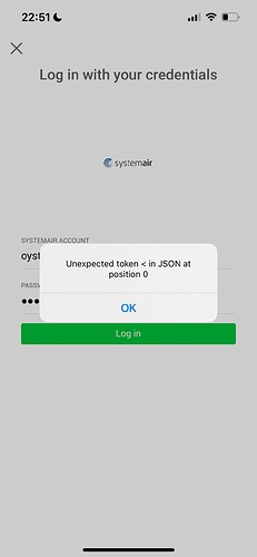

Hi.
I am trying to connect my Systemair IAM Cloud to my Homey pro. Error code: Unexpected token < in JSON at position 0.
Any tip??
Please read my post above.

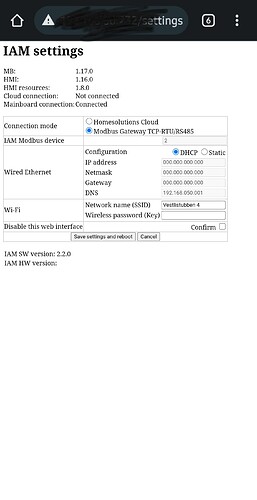

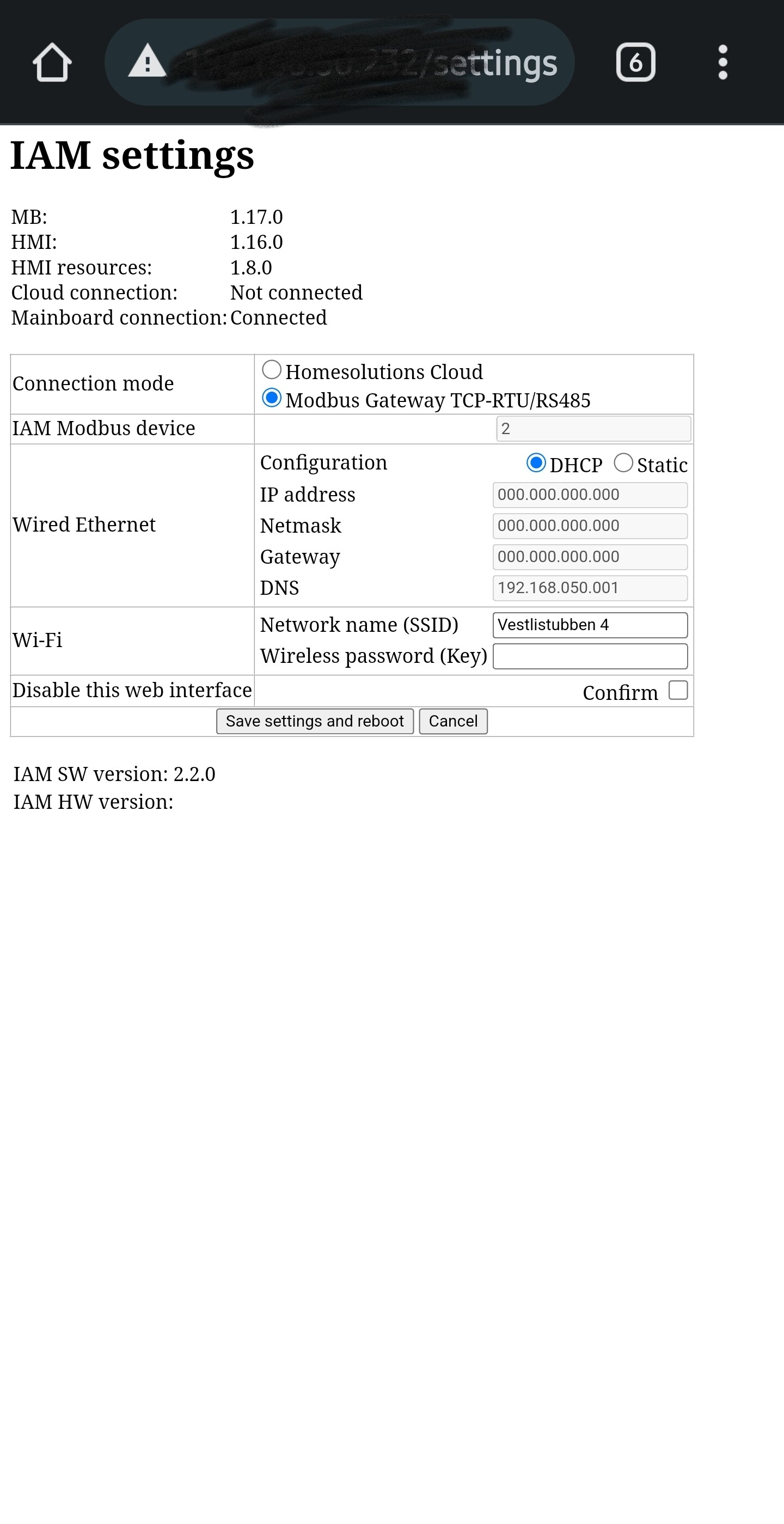

Thanks for your effort on this! I am also having problems finding the IAM.
I did set the IAM to Modbus mode. I am able to log in to the IAM using its IP-adress. Homey and the IAM are on the same network. I ran the app using CLI and got this line if that’s of any help.
[log] 2022-05-14 19:55:51 [ManagerDrivers] [Driver:SystemairIAMModbus] onPairListDevices {}
I have tried to connect the IAM using both WIFI and Cable with the same result (not found by the app)
The MAC-adress specified in the manifest for discovery is the same as printed on the back of my IAM and reported by command “arp -a” from my computer.
Not sure where to look further…
