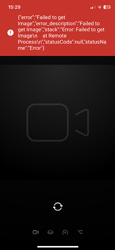

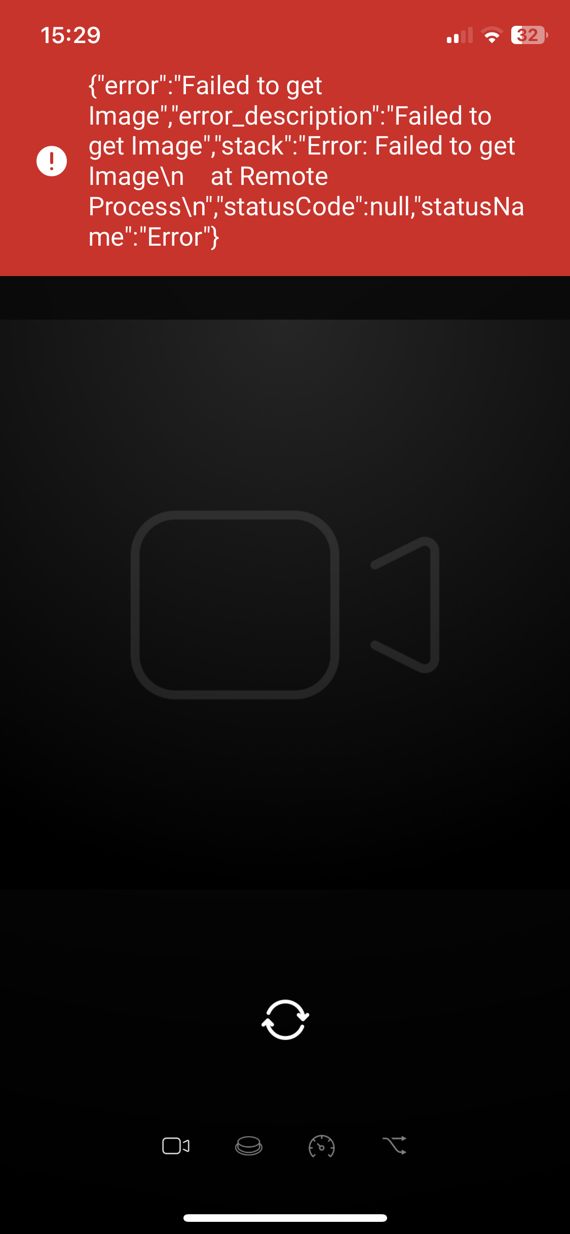

Unfortunately the next challenge arises. I can add my cameras from the NAS to homey. But they do no show live footage in Homey. It gives the error below:
Can you send a report @elfrigo
diagnostic report code
e918fae3-77ef-4b53-9064-94aa83a8c126
