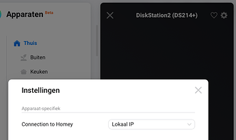

Also, in this release you can set change the wehbook-url that the synology uses to report motion, lost connections, changes in home mode etc. to the Homey. When you go to the Surveillance Station device in this app you can now choose between the cloud url (default) and local ip (please make sure your homey has a fixes ip).
Please let me know what you think.
