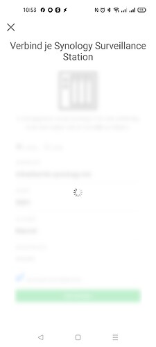

Since the last update Homey can’t connect to the Surveillance Station anymore. No error message, no time out, just the turning circle. I already did reset the Homey and the DS but no changes.
With the standard DS apps the connection works fine. I’m using app version 3.0.1 and Homey version 5.0.0
Do you have a screenshot for me so I can see where you get the turning circle?
It’s apearing right after I press the “Sent” button
