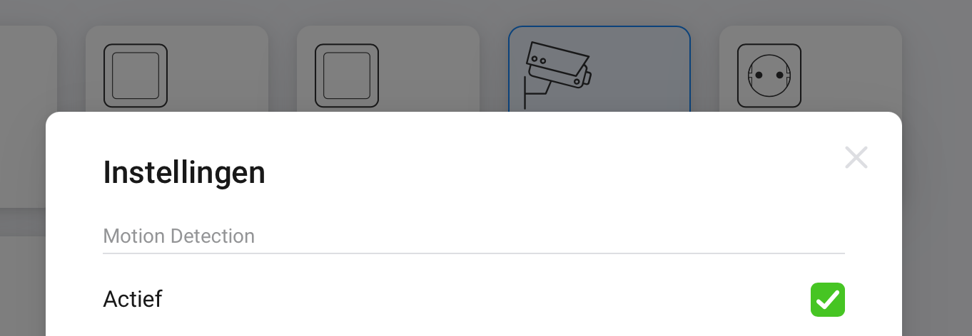

What is not working is ‘movement, the reason for installing this app’. In the SS DS CAM app I see the blue lines confirming there is movement. In the app and using a simple flow to make a notification in the timeline after movement, nothing happens. Home-mode is off.
Any idea?
Hi @Jomi , could you please validate 2 things for me that needs to be ok for motion detection to work properly.
1 - Advanced setting on the camera in Homey
The motion detection should be ‘active’.
2 - Action rule in Surveillance Station
Could you please login to your Synology and Surveillance Station and go to ‘Action rules’.
There should be a rule “Homey Motion Detection for [name of camera]” for the camera.
