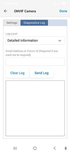

Could you open the app settings page and select the Diagnostics Log tab and set the log level to Detailed information. Then enable motion detection on the camera device in Homey and trigger motion on the camera. Finally, go back to the log and Send it.
Hi Adrian, Ok ive done that.
Thanks
