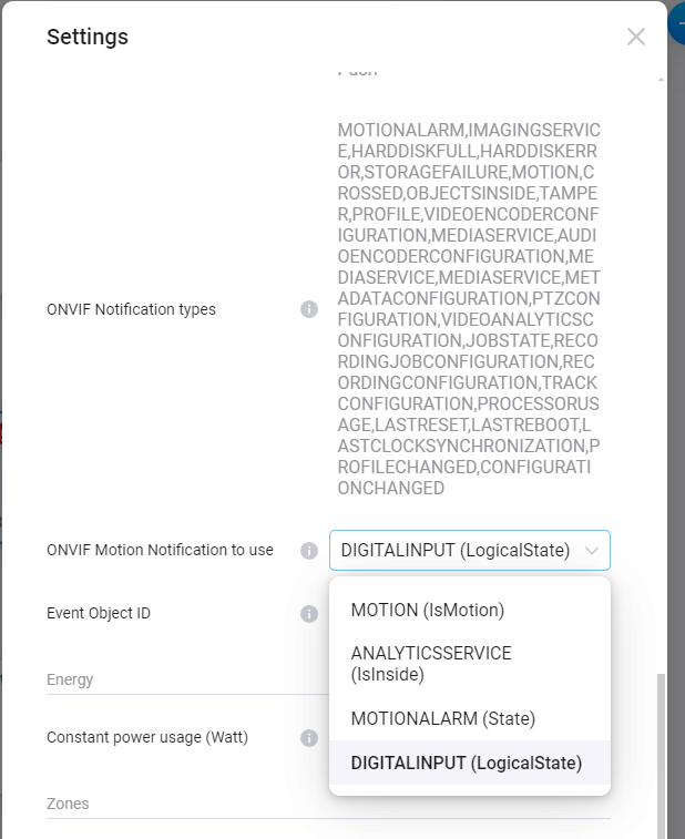

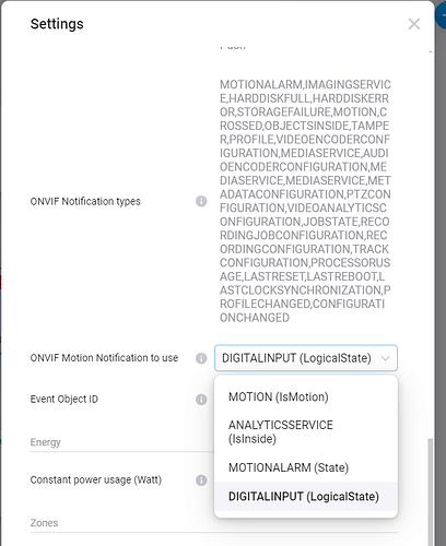

The only notification I can see setting to true is the DigitalInput. Where you pressing the doorbell button while logging?
Did you move in front of the camera?
To get notified for the DigitalInput, change the Advanced setting of the Homey camera device to use that:
I’ve send another log. There’s a switch on the back for sabotage alarm. It wasn’t pressed.
Have you tried the digital input setting to se if you get motion triggers?
That is the only event that is changing between true and false.
Yes no notifications
With the Digital Input selected, do you get a snapshot and motion alarm when the doorbell is pushed?
Can you send the log with that option selected?
I’ve send the log. No notification when pushed
