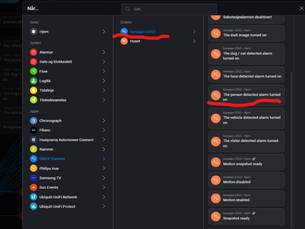

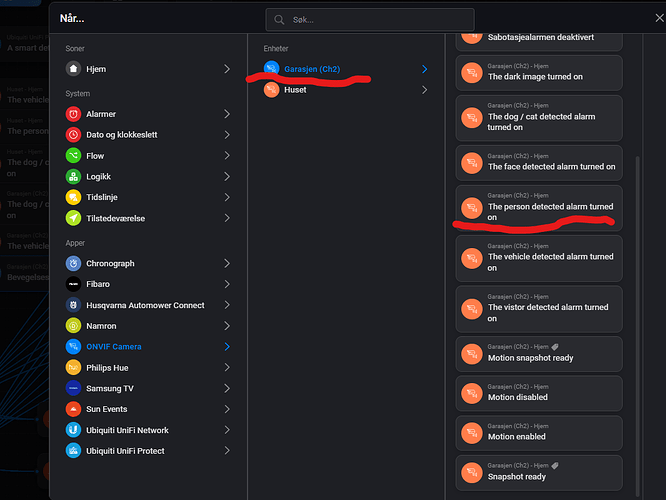

Hmmm, strange since it is two identical cameras and it only goes out for the garage mounted camera, and behold; today it is back :smiley:
On my first post it is not on the list.
Maybe the camera is not reporting it so when it connects it get’s removed, but it will be forced back in if a notification is received.
