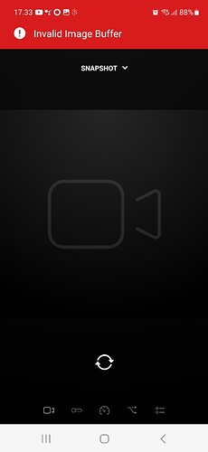

I have 5 reolink cameras
Trackmix, Doorbell, RlC520a and RLC822A
And a duo 2 wifi. Some is through an NVR, but i get same error with all cameras.
Could you look at this article and follow the settings link How to Capture Live JPEG Image of Reolink Cameras via Web Browsers – Reolink Support
Check to make sure the http is enabled.
You could also try changing the url configuration for the camera in the Homey app so it points to https instead of http as that should force the app to start with https and ignore certificate errors.
I have published a new test version which tried to ignore certificate errors on http connections. It sounds silly, but I can see your camera appears to be redirecting the http connection to https, so I’m hoping the option will be passed along when the fetch switches between http and https.
If it still fails the try changing the snapshot URL to:
https://192.168.50.11:443/cgi-bin/api.cgi?cmd=onvifSnapPic&channel=2
Notice the port number also needs to be changed from 80 to 443.

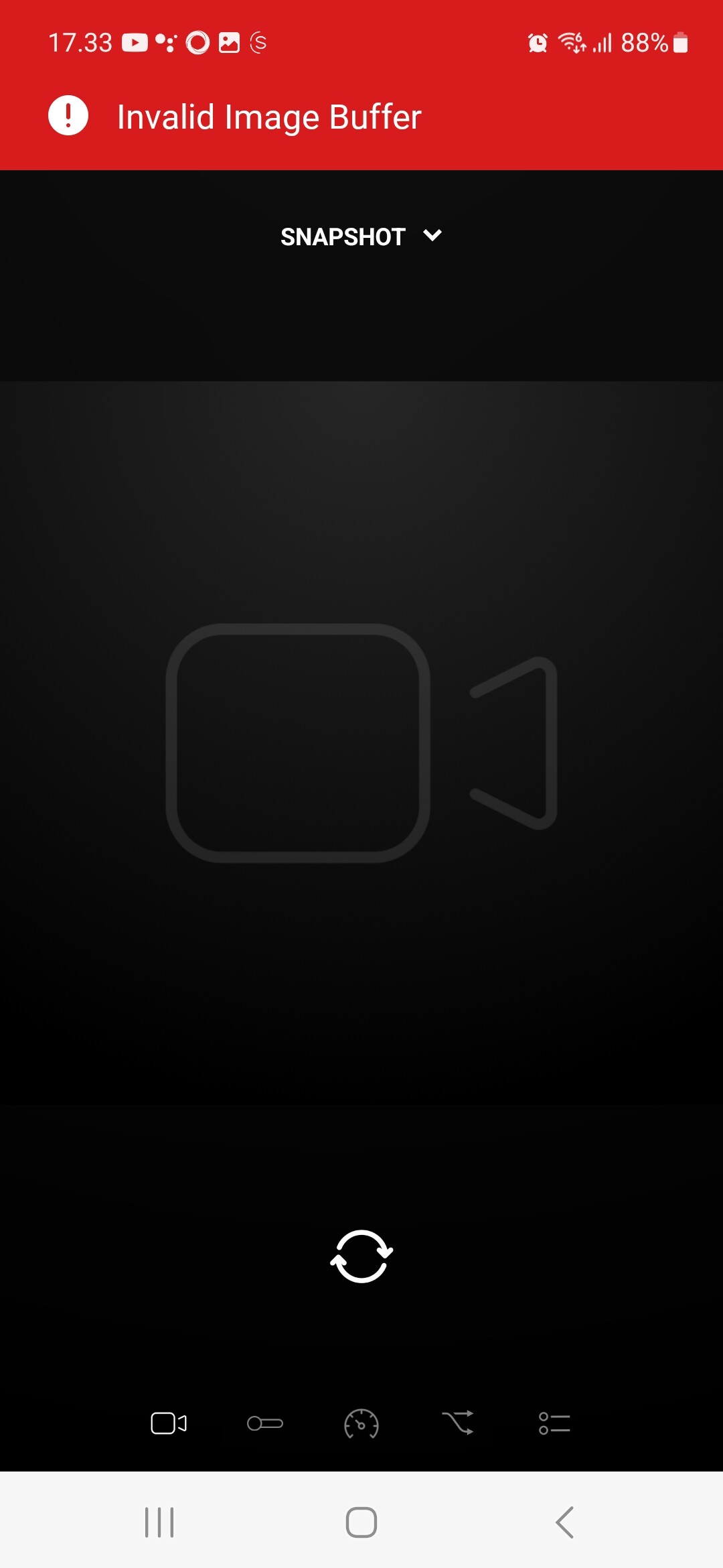

Like this ?
I noticed the port number is missing. Have you copied the existing URL and pasted it into the user URL box, then add the s to http and change the 80 to 443, but make sure everything else is the same?
Yes. I think it is working now :blush:

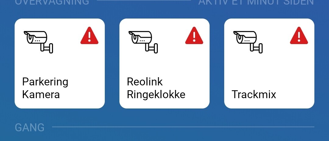

It says the app doesnt work now ?
Can you send the log from the Configure App screen.
I have published a new test version.
Looks like its working now.
Thanks.

The cameras went offline again ?
Can you send a Diagnostics report.
Then can you check if the app has been paused and try restarting it.
App restartet. I will try tomorrow to see if this works.
