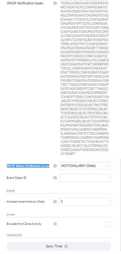

It didn’t seem to make any difference when it comes to Motion detection, also tried changing ā€œONVIF Motion Notification to useā€, with no change.
Have taken some snapshots of settings in device. I will try to send a new log file now.

On the second tab of the device, can you ensure that motion is enabled as in the image?
One thing I hadn’t thought about is when motion detection is not enabled, it won’t register to receive events, so the doorbell button won’t work either.
Can you check in the camera settings to see if anything needs to be enabled to send events?
