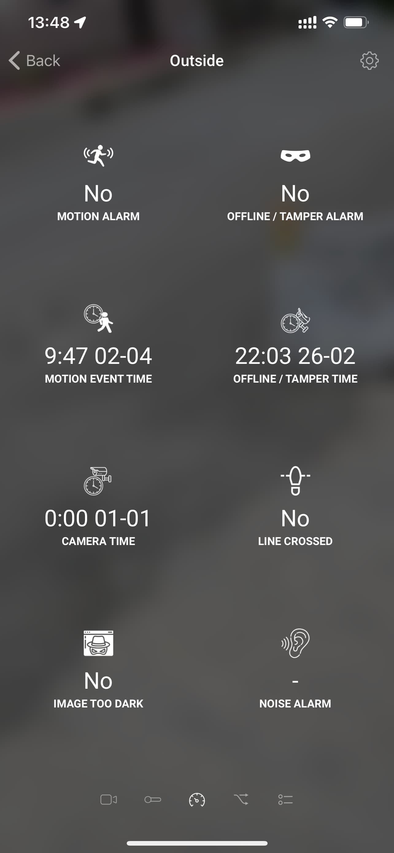

As I mentioned earlier, I use UNV cctv system at my home, I have 16 channel nvr, I managed to connect the cameras which are connected directly to the nvr poe connection, I can get the snapshot but the events/triggers are different from the other cams which are attached directly to my network using the poe switch (from same brand).
  1. camera connected directly to the nvr:
  2. camera connected to the network:
For camera 2, i can set if the motion detects a movement to send me a notification while for camera 1 i cant use it for the same purpose.
