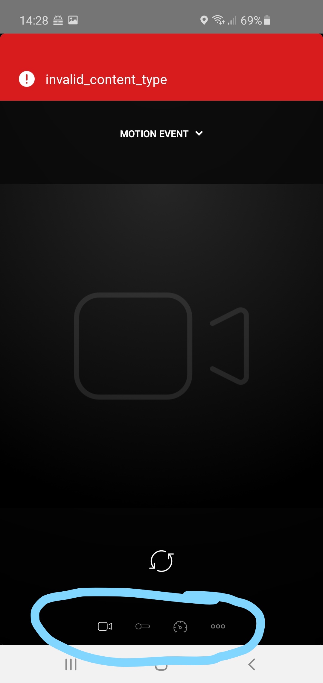

except (you know)my Ebell doorbell. Then you asked me to create a log. I have overwrite the app V.0.02 over V.0.06 (not deleted but i overwrite it) I went back to the installed hikvison cameras and get the following message (see screenshot) and have four screens
This screen has not been added to the other 3 screenshots

Not anymore. I deleted the app v.0.0.2 and install V.0.0.6 again. Everything workings normal but i didn’t have the screen with motion event.
Do you see the NOW image (drop down list when you touch on MOTION EVENT)?
Do you see the motion alarm indicate when motion is detected?

So i told i don’t have the motion event screen only the other three one.
Sorry Ben I am being a bit slow today. So are you saying you don’t see the picture you posted just above anymore (it was there but now it’s gone)?
Hi Adrian,
No problem. Yes, i don’t see the picture or screen with motion event not anymore. On this moment the hikvision camera’s are installed in Homey. When i go back to V.0.0.2 and overwrite the app V.0.0.6 and i didn’t not delete the camera’s in Homey and i go back to the camera’s in Homey and then he shows me the screen with motion event with the red error.
I will try to explain with the screenshots. When i installed V.0.0.6 and everything works perfect i have this screen’s
When i go back to V.0.0.2 without to delete the camera’s i have 4 screens
