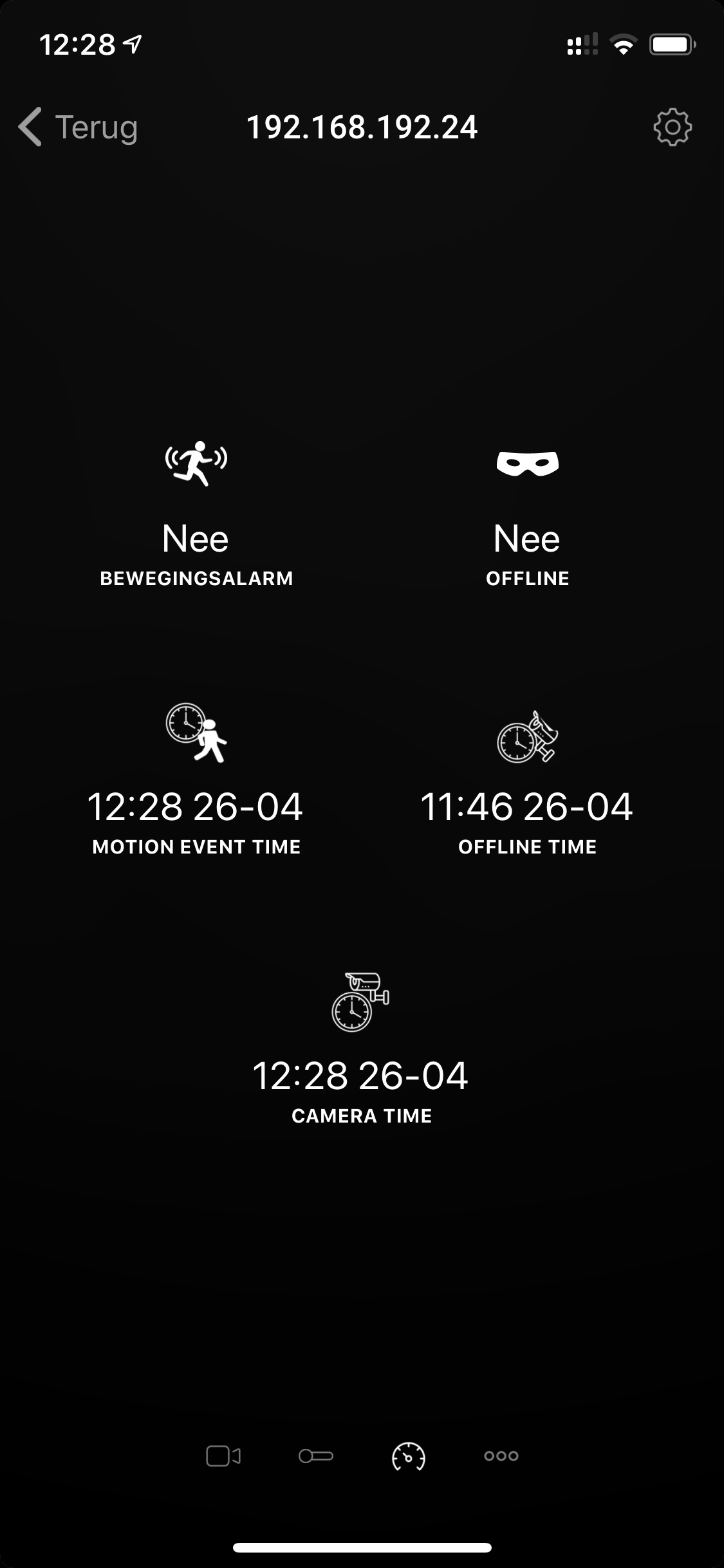

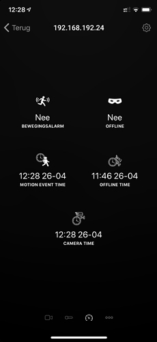

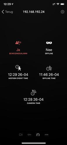

Adrian, I installed 0.0.16. I get the same error messages as at 0.015. I sent the log. The motion detection has stopped responding since version 0.0.14, in version 0.0.13 it worked.
OK, I will keep investigating.
Regards motion detection, I am not seeing that being switched on in the log. There should be the message ‘###### Waiting for events ######’ coming up just after ‘Supported Events:…’ if motion is switched on.
Adrian, you’re right. I forgot to turn it on in the app. motion detection works.

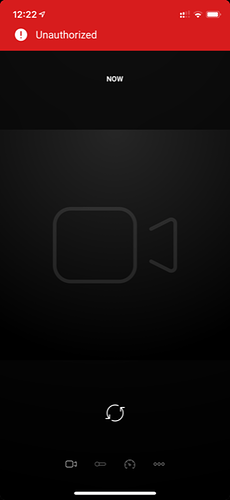

Can you confirm if the ‘NOW’ image is working or are both the ‘NOW’ and MOTION EVENT’ still broken?
Motion event works but Now event does not
When you say ‘event’ do you mean image, as in are you seeing the images themselves?
The reason I ask is the log only shows an error for the event image and not the now image.
And you say motion event works, so does that means you see an image there or just the alarm indicator activates?
I don’t see an image
Adrian I see the choice Motion Event in Ben’s post 4 days ago. I don’t have this choice
I had sort of come to that conclusion :slight_smile:
That confirms to me that the image is not working for either method.
I will continue to search for answers.
There is a new test version (0.0.17) that allows the snapshot URL to be overridden in the advanced settings. If the new setting is blank then the app will use the URL that is returned from the ONVIF getSnapshotURL function. However, if this URL does not work then you can enter the full URL to one that ‘hopefully’ does work.
If the URL requires your login credentials then you can either enter directly them as part of the URL or you can use #USERNAME# and #PASSWORD# as placeholders that are replaced with the previously defined user name and password.
@Octo maybe you can try this to see if another URL works for you.
Another test version (0.0.18) that adds ‘Authorization’: ‘Basic …’ headers to the image fetch commands.
Yet another test version (0.0.19) that:
  • Added the Authorization’: ‘Basic …’ headers to the event image fetch commands (previous version only added it to the NOW image).
  • Added an option to the advanced settings to switch Authorization html headers on / off. If you see the ‘Forbidden’ or ‘Unauthorised’ error message in the snapshot view then switch this option on.
I have added a description / instructions for the app to the first post.
A new test version is available (0.0.20) that adds Digest Authorization with auto detection when non, Basic, Digest headers are required.
Hopefully this should solve some of the ‘Unauthorised’ errors when fetching the snapshots form some cameras.
