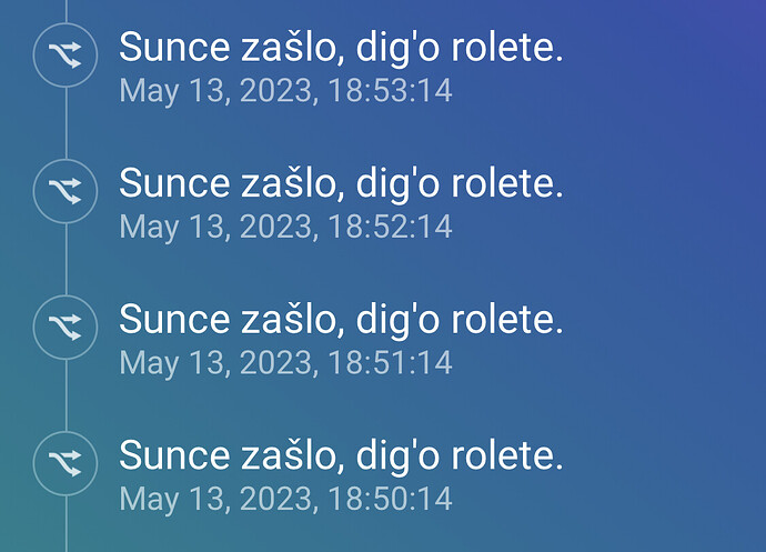

I set WHEN Altitude or Azimuth chages, AND it is exactly 13 or 195, THAN to this.
It triggers multiple times. It trigers 4 times.
How to solve this?
I can’t get it to trigger multiple times on an azimuth change.
Also, I don’t always receive even numbers.

So you can use something like this, to make sure it triggers only once:
Thank you. Will try with logic.

This is 4 times on “sunset” altitude.

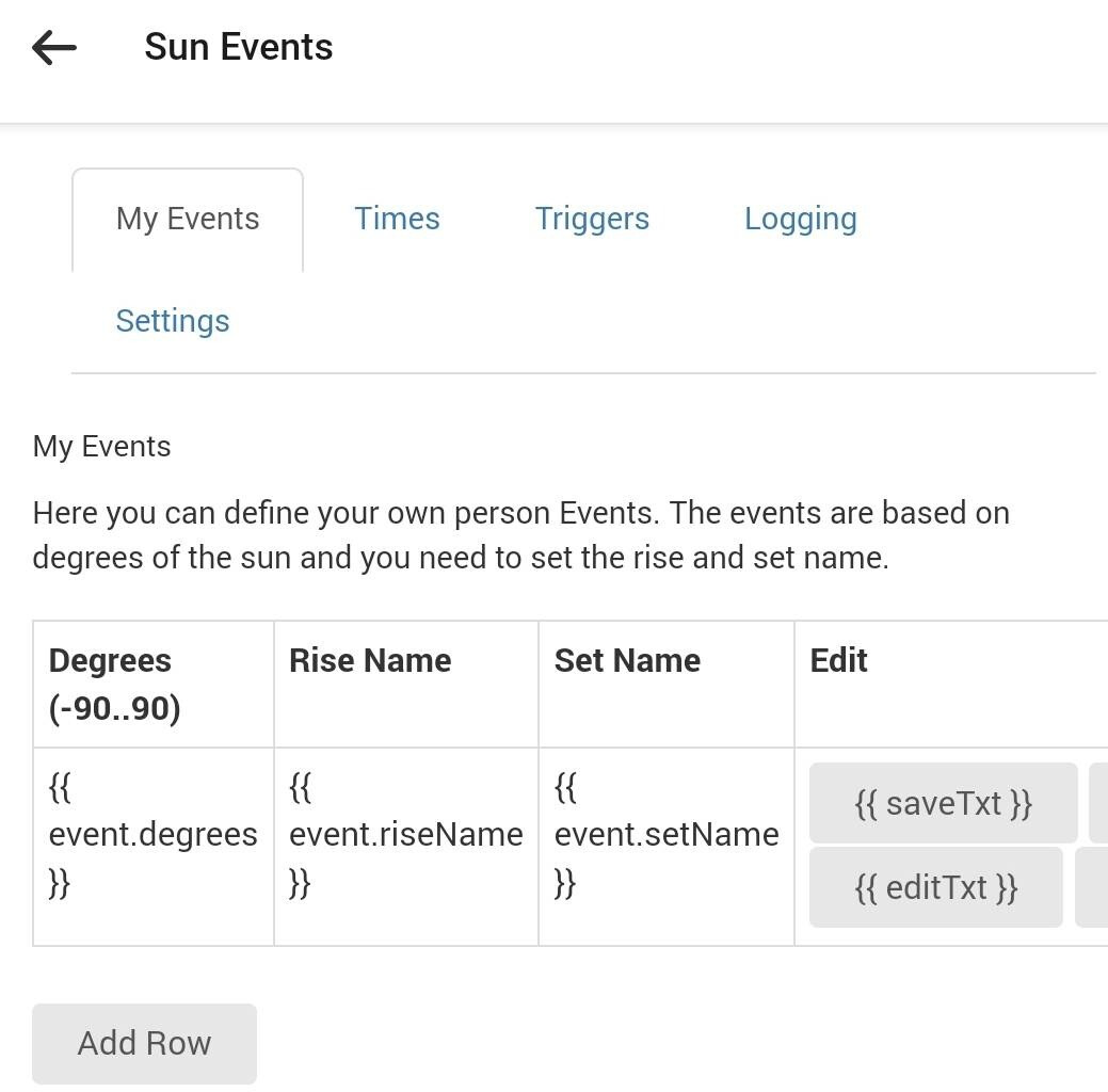

Does the Settings works for you on HP23 and SunEvents v2.1.1 ? Issue persist for me for several weeks already.
Interesting, it’s fixed by magic (probably by Athom on their side)

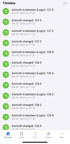

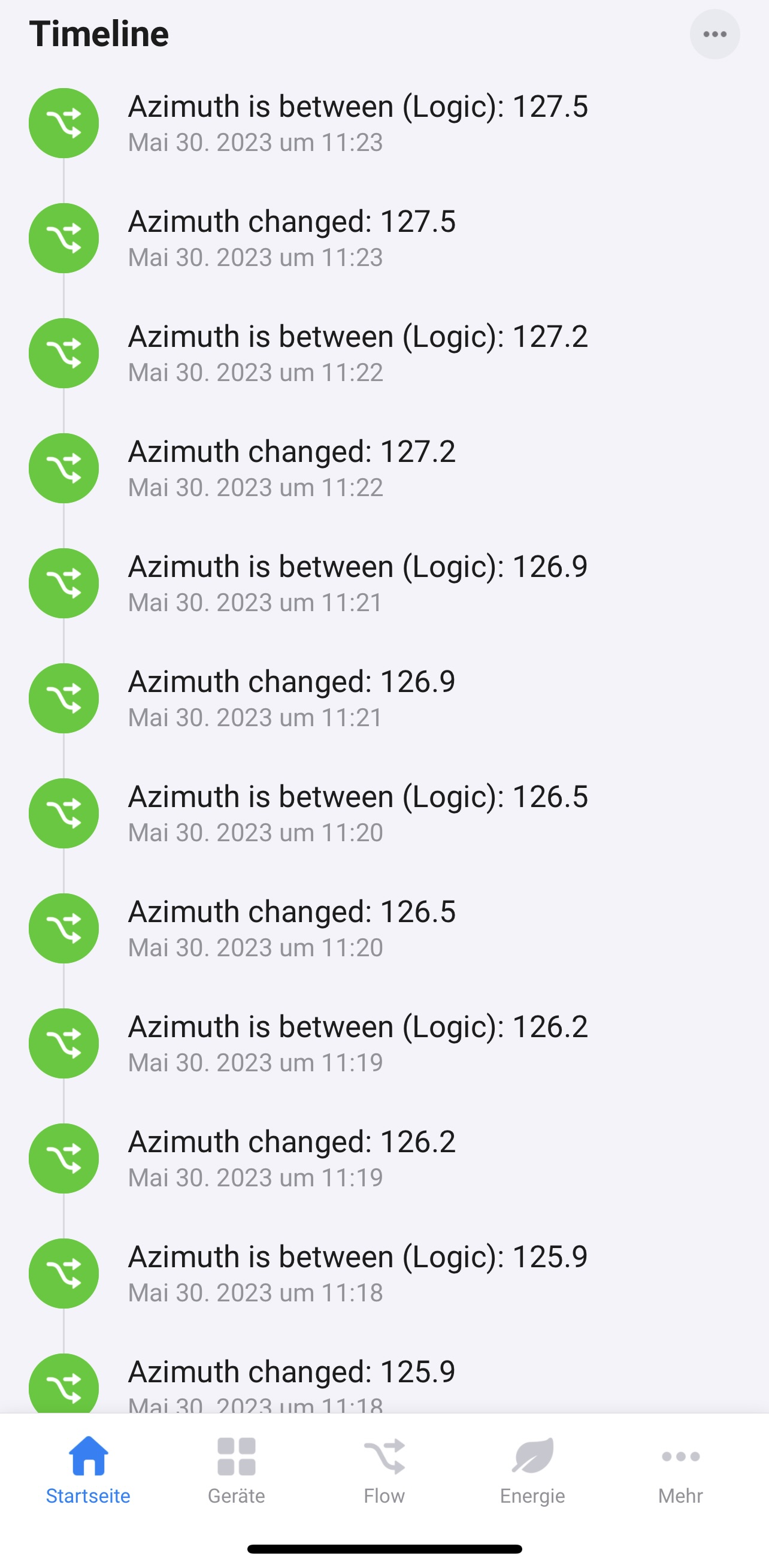

just found out, that the condition card “Azimuth is between X and Y” doesn’t work on HP19. On HP23 it works without problem.
Test flows:
Timeline results:
Diagnostic report no.: d2b7c0eb-b38f-4945-b911-8b9ae0d4281d
That’s wierd, seems like a bug in homey. But I will check.
