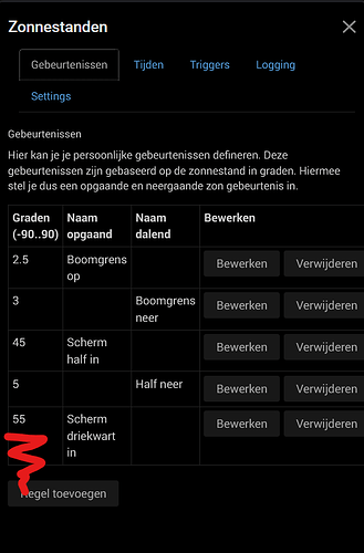

I’m using sun events to control the position of my screens and blinds. Last few weeks I noticed unexpected behavior for which I think I found the root cause.
I use multiple flow “and’” cards, type "time is after {event}; in combination with events linked to certain altitudes to set the blind position. Works perfect during mid summer.
At this time of the year, the sun does not reach the highest altitude of 55 degrees. But, the event is still created and the time for this event is set to 1 jan 1970, 01:00.
As actual time during the day is always later as 1:00, the "and"flow card still triggers a “true” condition, resulting the remaining part of the flow sets the wrong blind position.
More logical, expected behavior would be to not create the event if the altitude is not reached, or alternative, output “false” in the relevant flow cards.
Please check my reasoning, and if possible, change the flow card behaviour.

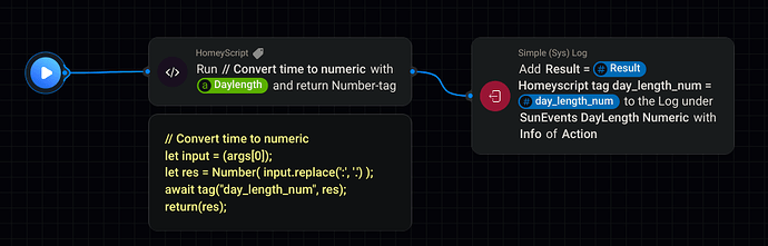

Is it possible to get the day length/how long the sun is up in a variable?
I’m using a growlight for my plants and if the daylight is shorter than x hours the light needs to be turned on.
I think this is already in the test version
Thanks i’ve found it. Only problem is that it’s a text tag and not a number :frowning:. So now i can’t use it for bigger/smaller than cards. Is it possible to change the ; to a . ?
Times are not possible in numeric format (inside Homey).
So you can convert it yourself when you need it as a numeric value.
(If this is offtopic, I’ll move it somewhere else)
With 3 variables and logics cards:
Or with a Homeyscript card “Run code with argument and return number-tag”,
and it creates a Homeyscript tag you can use in other flows:
That’s a neat solution :smiley: and something I can work with.
