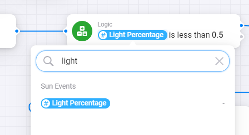

Well, i haven’t done any real logging. Just wrote a simple flow to mail me the light percentage every hour.

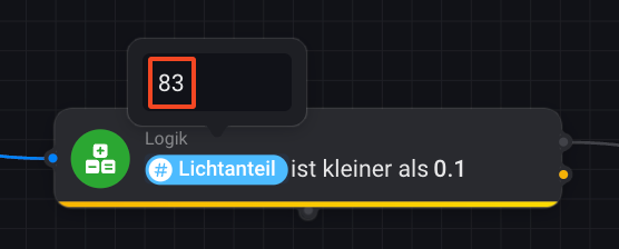

When I test a simple flow (Start → Logic → Notification) I get integer numbers again and no decimal numbers like you use for the logic flow cards:
So are you sure you use the right tag?
Well, when i type in “Light”…it only gives me the choice as you can see:

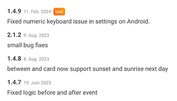

Btw., interesting numeration:
Homey Model :Homey Pro (Early 2023)
Version : v10.3.3
Sun Events : 1.4.8
Looks like i have an older Sun Events version. Maybe update might help.
@ZeroSugar Please use the latest test version:

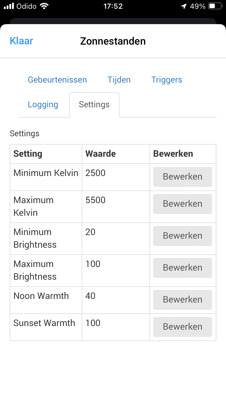

@MarcelT, what are the maximum and minimum Kelvin values? Searched this topic, the App Store and on and on the main page of GitHub, but didn’t found an info about that.
