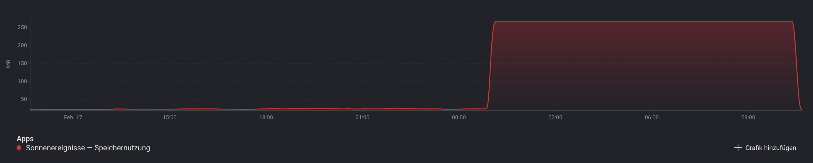

Ca. 270 MB! Time of the rise was about 1:00 o’clock.
(Might be interesting to post your offset from UTC)
:flushed: wauw that’s huge. Look like memory leakage. I will check it. I really do not understand such a high memory use as I have less modules and less code and smaller footprint.
So its UTC+1.
v2.0.2

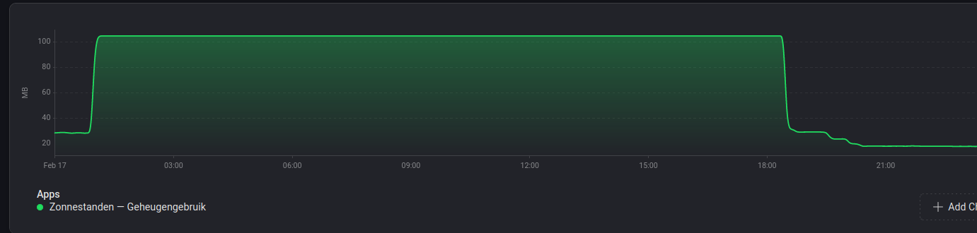

FYI similar behaviour here, Marcel, Feb 17 at just around 01:00 AM, also in UTC+1 tz.
I’m running v2.0.3 since then

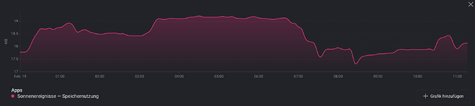

With v2.0.3 there was no problem last night:

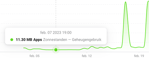

Arround the 12th of february the average memory goes up from 11mb to 25
