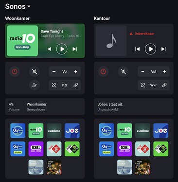

My living room Sonos speaker set is connected to a TV and that is connected to an HTPC. When I am updating and/or performing maintenance tasks on the HTPC (which requires the TV to be on, as that is the HTPCâs monitor) I donât want the music playing on the Sonos to stop. So I disable auto-play during maitenance and then re-enable it again after I am done.
Itâs a dashboard widget showing favorite radio stations. When tapping on an icon my Sonos starts playing that favorite station. I made a tutorial for how to create this widget over here:
