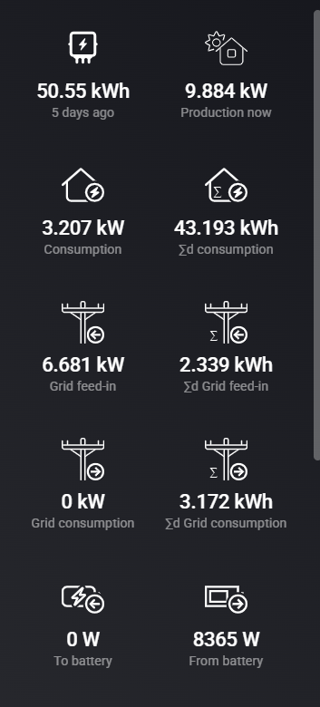

Testing the url link i get forbidden at home as well… I think the correct path is https://find-my.sonnen-batterie.com/
That path gives me this picture.
