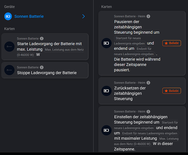

I am redoing my Sonnen flow for the new app, what I want to do is set a variable TOU to when I detect so does the Set Time of Use Cards accept @time variable , I believe the old version did ??
While separating into individual devices, some flow cards that were registered to the application before, got moved to the devices. Did you look into the “sonnenBatterie” device for the “then”-cards for time-of-use functionality?
There should be cards for with a time picker as well as string-based cards

Is there any plans to add support for “Charge/Discharge battery” that is documented in “sonnenBatterie JSON API v2 documentation”, that would be really nice.
/Rikard
Please look at the options available in this release:
Check settings on device.
You can use the manual charge/discharge actions cards as of v2.1.0. Might need to switch to manual operating mode as otherwise any other setpoint update might overrule when in e.g. self-consumption.
