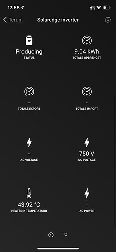

I want to use the values of the app for a Dashboard, MQTT based. For as I can see the MQTT topics are not created by the app. I use the MQTT Hub app at the Homey and MQTT Explorer.
These topics are made
  • homey/solarpanel/[location]/[name device]/$name
  • homey/solarpanel/[location]/[name device]/$type
And these topics are missing:
Solaredge - Solar Power
homey/solarpanel/[location]/[name device]/measure-power
Solaredge - Heatsink temperatuur
homey/solarpanel/[location]/[name device]/measure-temperature
Solaredge - DC Voltage
homey/solarpanel/[location]/[name device]/measure-voltagedc
Solaredge - Totale opbrengst
homey/solarpanel/[location]/[name device]/meter-power
Solaredge - Status
homey/solarpanel/[location]/[name device]/status
May be it is a feature request. Any help would be appreciated.

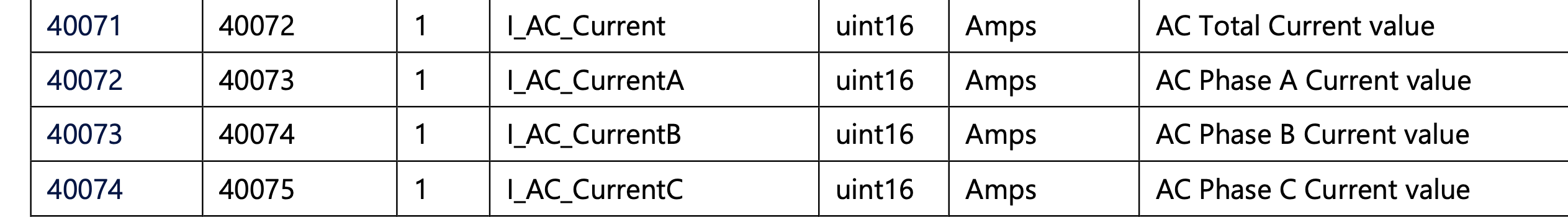

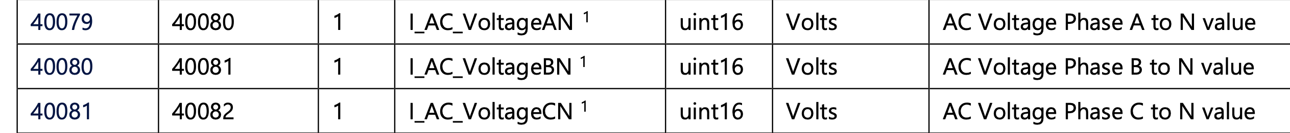

Would be nice to monitor the voltage of each phase:
Also for current of each of the fase and combined:
This one is nice to have:

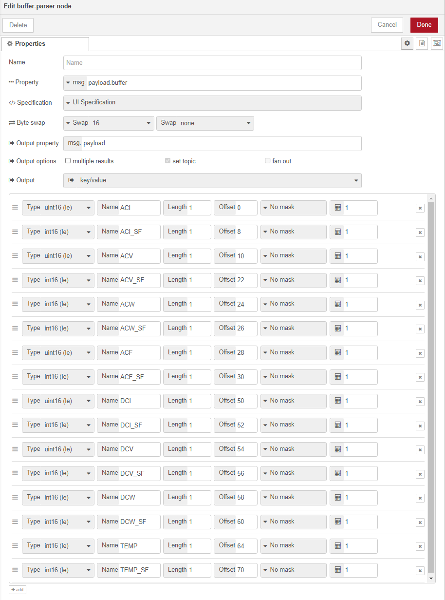

Ruben, if you have node-red you could read the values yourself. This video Obtén los datos de tu Inversor Solar shows how to read your inverter using node-red-contrib-modbustcp. You can figure out and read the values you want. It’s in spanish though.
the nodes required to read an process the values
this is an example how to read the buffer values
This is great. Thank you.
Can you share the node-red code here so I scan use it as reference?
With home assistant, you can also get all the values.
I will try next week to release the 3-phase support

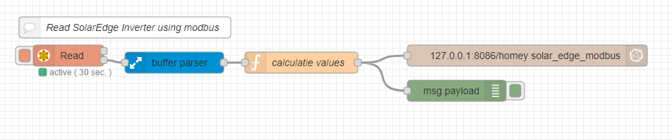

Arnold, below are the nodes I’m using to extract data from my SolarEdge Inverter every 30 seconds.
[{"id":"f3c2fd317aa56a7a","type":"modbus-read","z":"876db62c.d628f","name":"Read","topic":"","showStatusActivities":false,"logIOActivities":false,"showErrors":false,"unitid":"1","dataType":"HoldingRegister","adr":"40071","quantity":"38","rate":"30","rateUnit":"s","delayOnStart":false,"startDelayTime":"","server":"db92a57b3119cab2","useIOFile":false,"ioFile":"","useIOForPayload":false,"emptyMsgOnFail":false,"x":970,"y":780,"wires":[[],["53c6de8182c62fd2"]]},{"id":"53c6de8182c62fd2","type":"buffer-parser","z":"876db62c.d628f","name":"","data":"payload.buffer","dataType":"msg","specification":"spec","specificationType":"ui","items":[{"type":"uint16le","name":"ACI","offset":0,"length":1,"offsetbit":0,"scale":"1","mask":""},{"type":"int16le","name":"ACI_SF","offset":8,"length":1,"offsetbit":0,"scale":"1","mask":""},{"type":"uint16le","name":"ACV","offset":10,"length":1,"offsetbit":0,"scale":"1","mask":""},{"type":"int16le","name":"ACV_SF","offset":22,"length":1,"offsetbit":0,"scale":"1","mask":""},{"type":"int16le","name":"ACW","offset":24,"length":1,"offsetbit":0,"scale":"1","mask":""},{"type":"int16le","name":"ACW_SF","offset":26,"length":1,"offsetbit":0,"scale":"1","mask":""},{"type":"uint16le","name":"ACF","offset":28,"length":1,"offsetbit":0,"scale":"1","mask":""},{"type":"int16le","name":"ACF_SF","offset":30,"length":1,"offsetbit":0,"scale":"1","mask":""},{"type":"uint16le","name":"DCI","offset":50,"length":1,"offsetbit":0,"scale":"1","mask":""},{"type":"int16le","name":"DCI_SF","offset":52,"length":1,"offsetbit":0,"scale":"1","mask":""},{"type":"uint16le","name":"DCV","offset":54,"length":1,"offsetbit":0,"scale":"1","mask":""},{"type":"int16le","name":"DCV_SF","offset":56,"length":1,"offsetbit":0,"scale":"1","mask":""},{"type":"int16le","name":"DCW","offset":58,"length":1,"offsetbit":0,"scale":"1","mask":""},{"type":"int16le","name":"DCW_SF","offset":60,"length":1,"offsetbit":0,"scale":"1","mask":""},{"type":"int16le","name":"TEMP","offset":64,"length":1,"offsetbit":0,"scale":"1","mask":""},{"type":"int16le","name":"TEMP_SF","offset":70,"length":1,"offsetbit":0,"scale":"1","mask":""}],"swap1":"swap16","swap2":"","swap3":"","swap1Type":"swap","swap2Type":"swap","swap3Type":"swap","msgProperty":"payload","msgPropertyType":"str","resultType":"keyvalue","resultTypeType":"output","multipleResult":false,"fanOutMultipleResult":false,"setTopic":true,"outputs":1,"x":1120,"y":790,"wires":[["e86e71c36d60ebc9"]]},{"id":"56478ebcc02294f7","type":"debug","z":"876db62c.d628f","name":"","active":false,"tosidebar":true,"console":false,"tostatus":false,"complete":"false","statusVal":"","statusType":"auto","x":1520,"y":830,"wires":[]},{"id":"e86e71c36d60ebc9","type":"function","z":"876db62c.d628f","name":"calculatie values","func":"result = {};\nresult.payload = {};\n\nresult.payload.ACI=msg.payload.ACI*Math.pow(10,msg.payload.ACI_SF);\nresult.payload.ACV=msg.payload.ACV*Math.pow(10,msg.payload.ACV_SF);\nresult.payload.ACW=msg.payload.ACW*Math.pow(10,msg.payload.ACW_SF);\nresult.payload.ACF=msg.payload.ACF*Math.pow(10,msg.payload.ACF_SF);\n\nresult.payload.DCI=msg.payload.DCI*Math.pow(10,msg.payload.DCI_SF);\nresult.payload.DCV=msg.payload.DCV*Math.pow(10,msg.payload.DCV_SF);\nresult.payload.DCW=msg.payload.DCW*Math.pow(10,msg.payload.DCW_SF);\n\nresult.payload.TEMP=msg.payload.TEMP*Math.pow(10,msg.payload.TEMP_SF);\n\nreturn result;","outputs":1,"noerr":0,"initialize":"","finalize":"","libs":[],"x":1300,"y":790,"wires":[["56478ebcc02294f7","03c63fa1208cc71d"]]},{"id":"9a2e3aef8c189951","type":"influxdb out","z":"876db62c.d628f","influxdb":"6996f3e5.22a7cc","name":"","measurement":"solar_edge_modbus","precision":"","retentionPolicy":"","x":1860,"y":760,"wires":[]},{"id":"692143e91f42a266","type":"comment","z":"876db62c.d628f","name":"Read SolarEdge Inverter using modbus","info":"","x":1050,"y":740,"wires":[]},{"id":"03c63fa1208cc71d","type":"function","z":"876db62c.d628f","name":"daytime check","func":"var date = new Date();\nvar sunrise = global.get('sun_events.sunrise');\nvar sunset = global.get('sun_events.sunset');\n\nmsg.daytime = false;\n\nif (sunrise && sunset ) {\n    if (date >= sunrise && date <= sunset) {\n        msg.daytime = true;\n    }\n}\n\nnode.status({text: 'Power: '+ msg.payload.ACW.toFixed(0) +'W - daytime: ' + msg.daytime + ' last checked (' + date.toLocaleString() + ')' });\n\nif (msg.daytime) {\n    return msg;\n}\nelse {\n    return null;\n}\n","outputs":1,"noerr":0,"initialize":"","finalize":"","libs":[],"x":1530,"y":780,"wires":[["9a2e3aef8c189951"]]},{"id":"db92a57b3119cab2","type":"modbus-client","name":"Solar Edge","clienttype":"tcp","bufferCommands":true,"stateLogEnabled":false,"queueLogEnabled":false,"tcpHost":"192.168.1.29","tcpPort":"1502","tcpType":"TPC-RTU-BUFFERED","serialPort":"/dev/ttyUSB","serialType":"RTU-BUFFERD","serialBaudrate":"9600","serialDatabits":"8","serialStopbits":"1","serialParity":"none","serialConnectionDelay":"100","unit_id":"1","commandDelay":"1","clientTimeout":"1000","reconnectOnTimeout":true,"reconnectTimeout":"2000","parallelUnitIdsAllowed":true},{"id":"6996f3e5.22a7cc","type":"influxdb","hostname":"127.0.0.1","port":"8086","protocol":"http","database":"homey","name":"","usetls":false,"tls":""}]
below is the data as shown in Grafana
