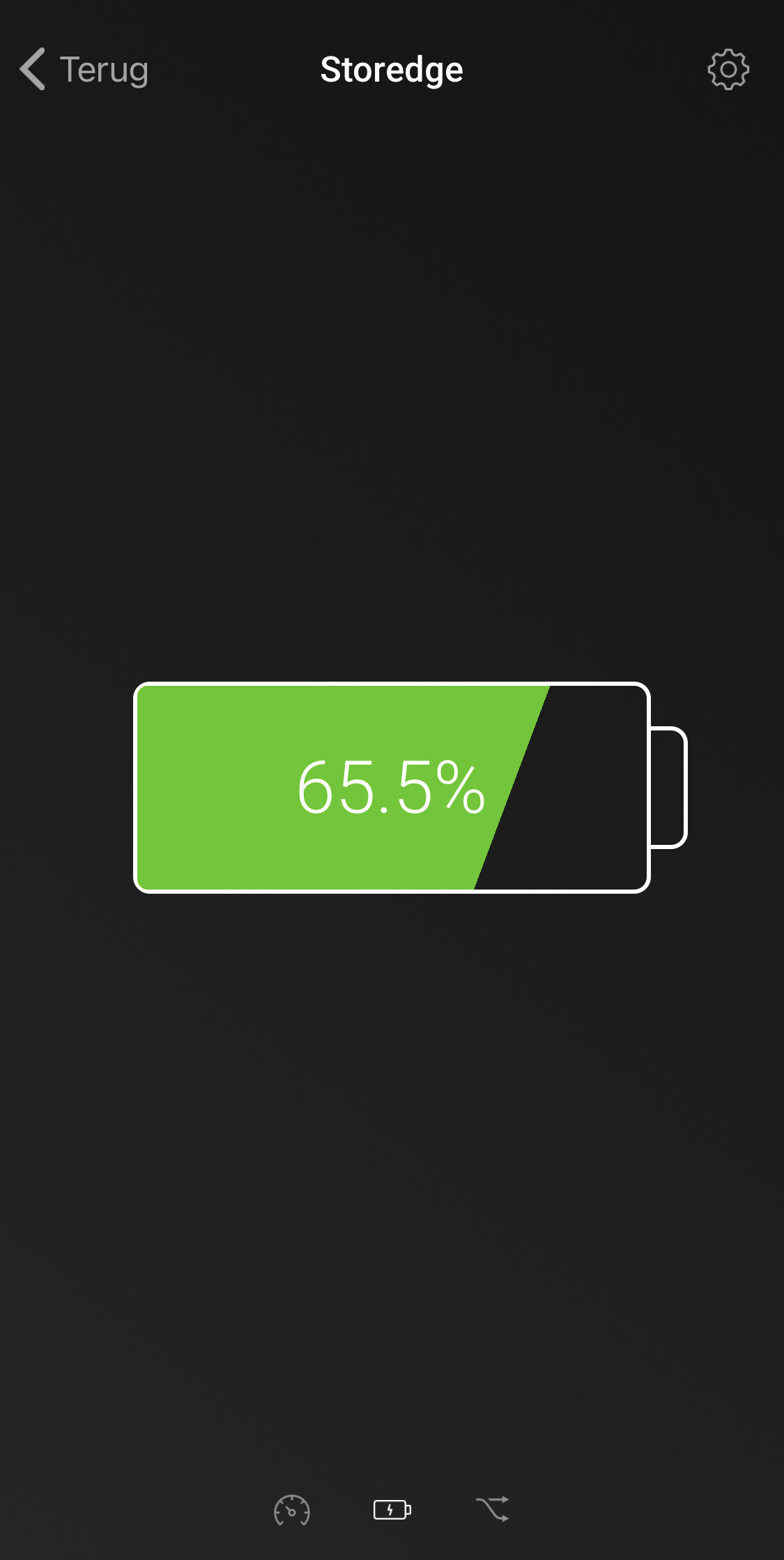

For those with batteries, v.1.2.0 is now available for testing with StorEdge implementation.
