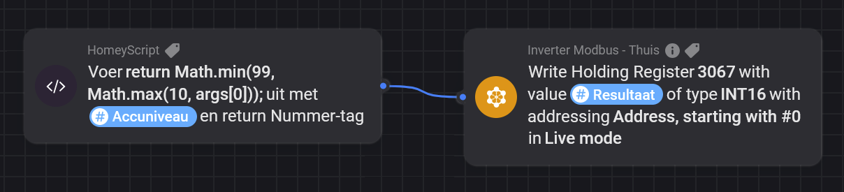

I’ve also added a small JavaScript snippet to ensure the value stays between 10% and 99%, since setting it to 100% triggers a warning online
