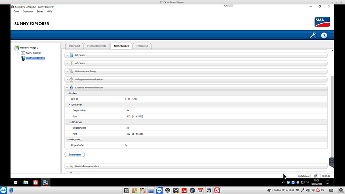

Finally able to borrow my moms laptop… Everything is changed as described in the Installers menu… But no data in homey
I’m logged in as an installer but I can’t find the menu where to unlock the connection.
Hi @copiis you didn’t login properly (wrong pin?) since the green checkmark is missing behind the serial number…
You were right, it was the wrong password.
Now I am logged in and have set everything to Yes but still don’t get any values in the app.
OK, i restarted the app and now it works
@copiis Yesssss the restarting was the icing on the cake… Restarting and one night of patience did it for me also…
