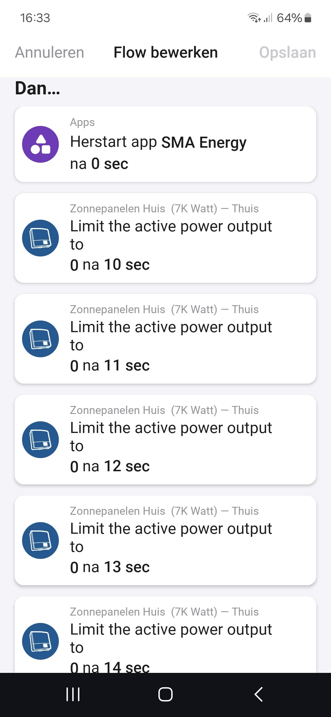

Dit is voor het uitschakelen:
Dit is voor het aanzetten (mijn omvormer is 7000 Watt):

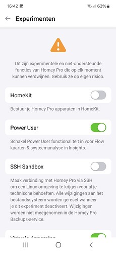

Zorg wel dat je dat je “Power User” bent in Homey anders kun je in de flow de app niet herstarten. Dit doe je in de Homey instellingen bij “Experimenten”. Zie hier:
Laat even weten of gelukt is want dan weet ik ook of ik niet de enige ben die dit heeft.

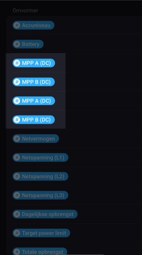

Is it possible to have better descriptive fieldnames and add the remaining ( Watt or Ampere or Volt )?
MPP: Maximum Power Point
You can connect 2 ‘strings’ to your inverter, SMA calls them MPP A & MPP B.
These tags show the DC output of these strings if I’m correct.
1, If you add the tags in e.g. a timeline card, you will see the corresponding values.
Previously, the values were directly visible in the overview you showed. I think it still shows with Pro 2019 models.
2, check insights to see the values
This line seems to mean you can rename them?
That helped a lot, thanks…
Do you have/know a solution to add the W/A/V ?

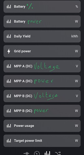

Imho these capabilities should be renamed to something like this:
Not only there, but also if you use a value in the app “device capabilities” you don’;t know what you’re choosing. You have the “V/W” there … ( and “A” is missing )
I get that. If they are renamed in the app, it will be visible everywhere :wink:
That’s why it would be very nice when the capabilities get renamed by @Richard_B ; For example in advanced virtual device you will see (following my example)
MPP A (DC) Voltage
and
MPP A (DC) Power
instead of two similar MPP A (DC) capabilities.

It is easy to add the power and voltage additions to the MPP A/B and Battery.
The battery (%) comes from the built in capability in Homey. Lack of % sign then.
