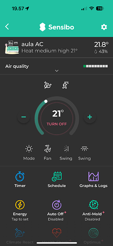

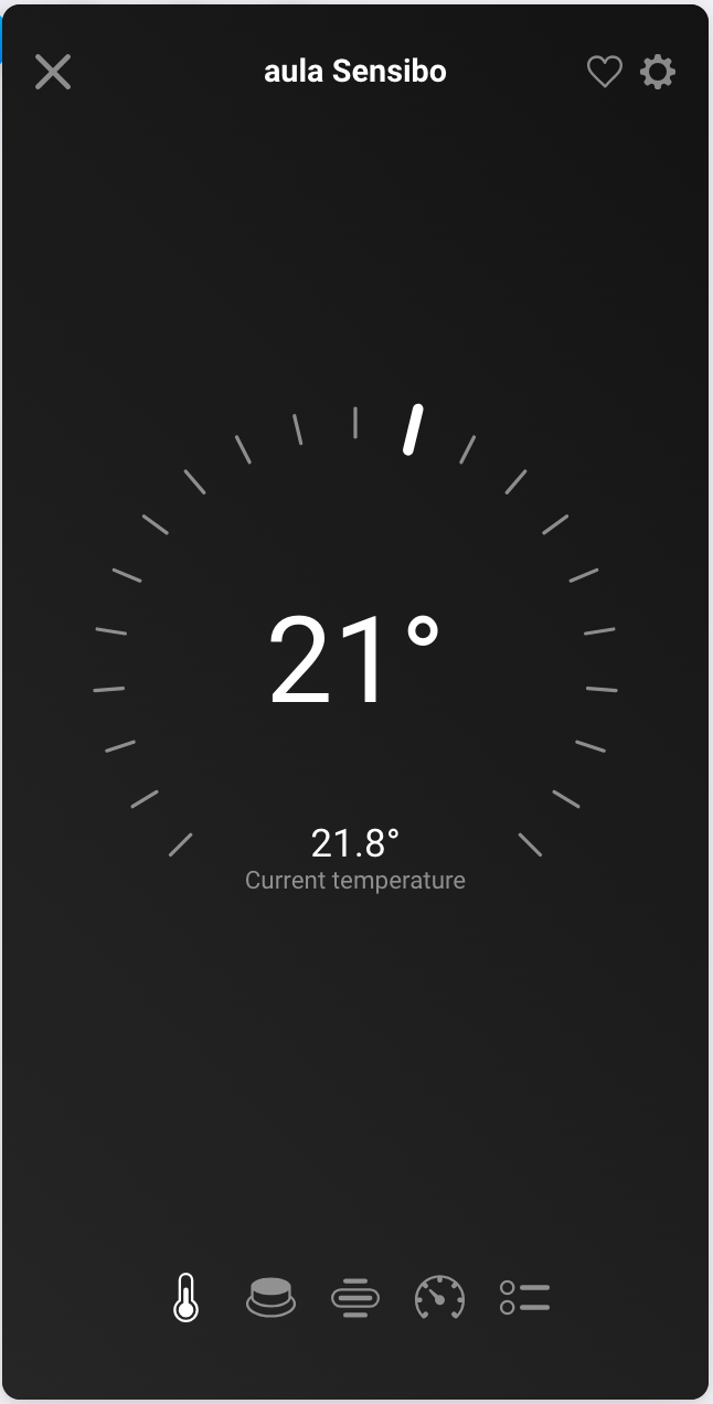

If the flow card ***The temperature changes” works with the logic card, then there may be something wrong with the other two cards (“becomes greater/less”). However, I can’t imagine this is the case in general.
According to the SDK documentation, the current temperature in the device card should indeed be displayed with one decimal:
(Source)
(Source)
So my suggestion is also to contact the app developer.

Thanks @DirkG, and you are right the Target Temperature and Measured Temperatures are the standard capabilities as they are defined in Homey.
Only override is for the Target Temperature that the step for changing the value is every 1 degree, like it is on the Sensibo mobile app.
Both are showing correct with one decimal, then again in Europe we use centigrades. Homey also internally uses centigrade for all calculations only converts the value to fahrenheit for presentation in the UI.
I am now testing also the flow cards to verify your situation:
but since those are the ones provided by Homey as standard for thermostats having measure_temperature capability, there is not much I can do to change that. However if we do find a bug, we can report it to Athom and hope for the best.
