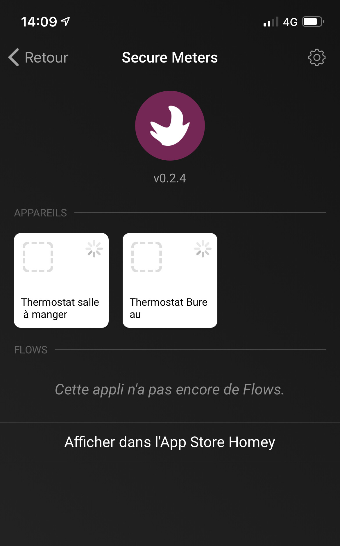

[APP][Pro] Secure / Horstmann app
Always down
@Joe1
What version of Homey are you running?
The app requires v5.
Which devices do you have?
Hello v 5 homey SRT321
