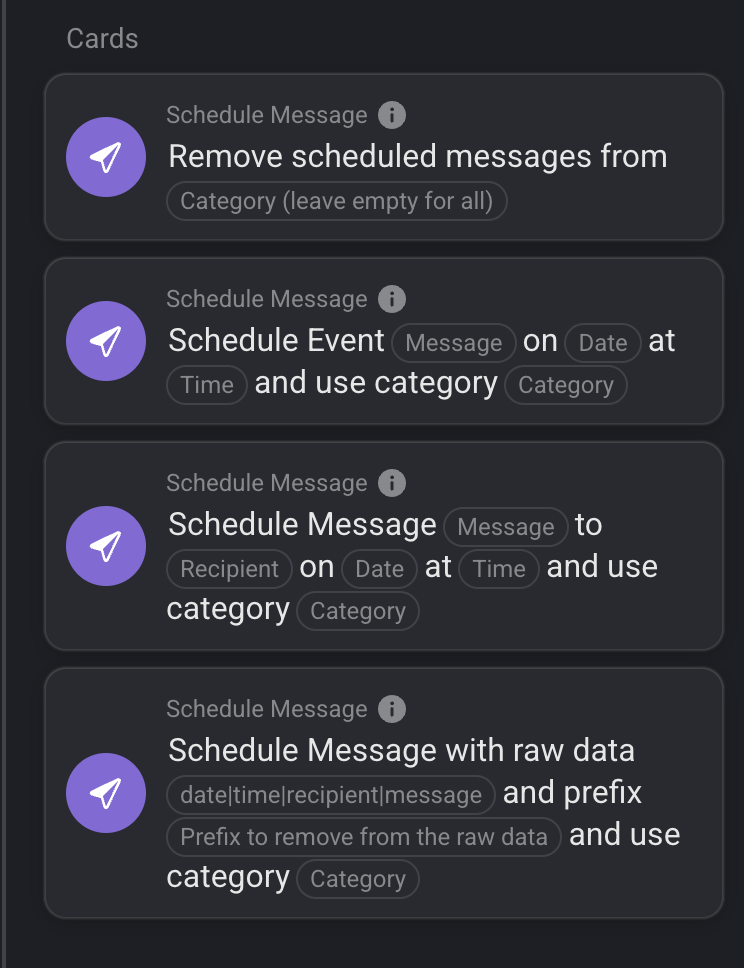

  2. Create a flow using the “Schedule Message” or “Schedule Event” action card.
  3. Enter the message, date, time, and optionally a recipient and category.
  4. The app will trigger the scheduled message at the specified time, allowing other apps to process or forward it.
Advanced:
  • Use the “Schedule Message (raw)” action card to schedule messages using a single text string in the format:
    date|time|recipient|message
    Example: 04-12-2025|12:00|+31612341234|Hello World
  • You can also use a prefix to strip from the raw data if needed.

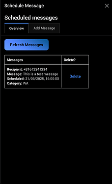

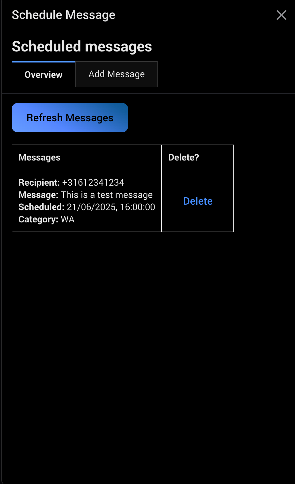

1: NEW: add settings page
2: NEW: add delete flowcard

Though when adding a message via the settings page recipient and category are swapped on the overview page, and the recipient is empty, unlike the flow card, where recipient then is Unknown recipient
@Caseda will check

@Caseda Fixed :slight_smile:

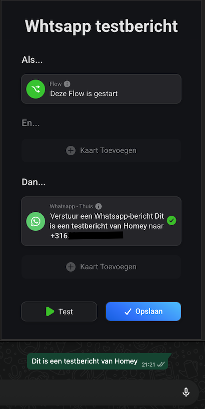

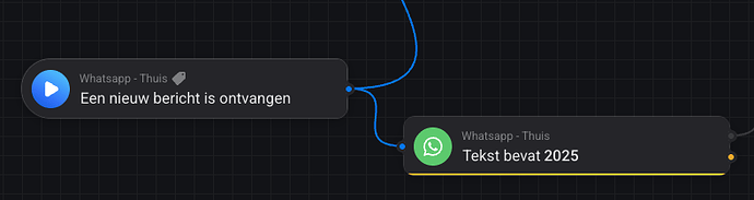

Hi @marijnpoppen, this app is really cool, but I can’t get the “And” card to work. I simply can’t figure it out; I’ve been testing and messing around for over half an hour. Everything else seems to work. When I run tests without this And card, it works just fine. Do you have a golden tip for me? Even when I run the test with the message “2025” and the “And” card is “text contains 2025,” it doesn’t work.
Edit: when I try it now on WA, it does work :smiley:.

@TheBigFella for the AND card to work (which is a WhatsApp app question, so better in different topic) you have to send a message
Test mode doesn’t work for WhatsApp
Tried with 2025 added to the text message as well?
Ah right, that’s it then. I got it to work now, by testing it trough Whatsapp only.
@Peter_Kawa - The problem was that testing doesn’t work for WhatsApp.
