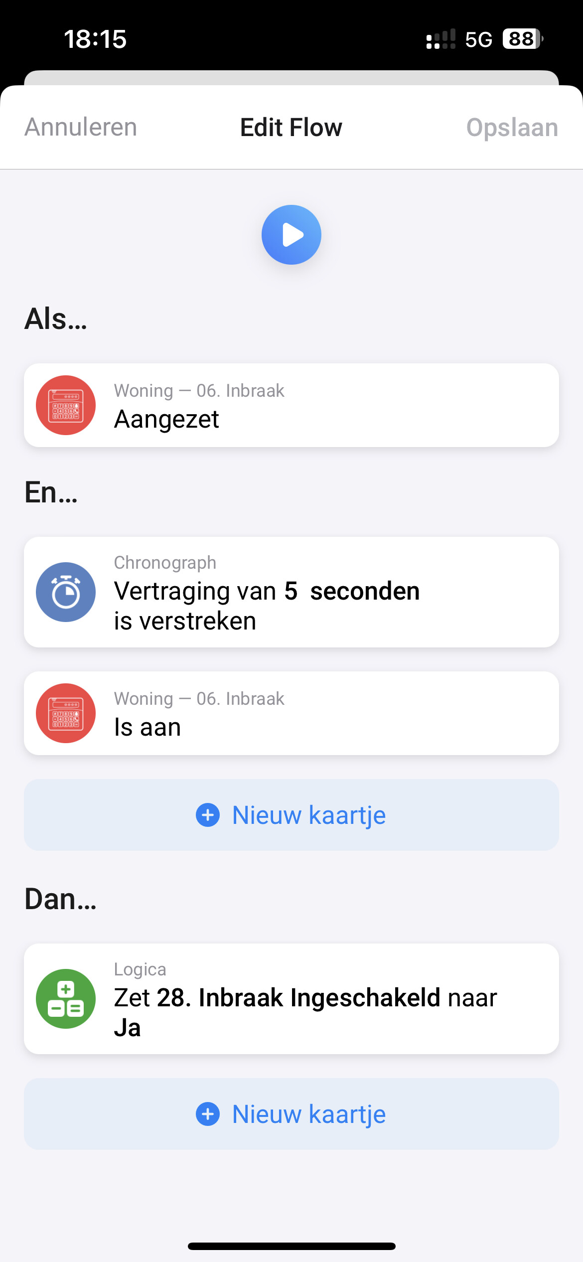

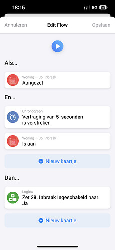

I have the same problem, solved this with a logic that delays switching to avoid flashing lights and more :wink:
Was thinking about that to but i have some issues with that. Can you share how you delayed the logic? Or did you just only delayed the writing of it?
Is this how you did it?
If system is arming
then → delay 30 sec → write logic “not home”
Some explanation how it works.
When a flow arm the system, the app send the arm command to satel panel.
But the satel.panel isn’t armed yet because of the entry/exit delay that is programmed in the panel…do to polling the app(homey) gets the unarm status back untill the satel is really armed after entry/exit delay is finished.
That is the reason…can’t fixed that unfortunately.
A delay or a extra control step should work.
Or make a variable 1 or 0…
When system is armed set variable to 1 and when unarmed set it to 0.
Second flow, when variable is 1,delay 2 sec And system is armed do …
I think this should work not tested
This solution works great!
Thanks! that did the job didn’t know the chronograph app.
@Mickel_Luiten thanks for the clear explanation.
This trick working correct now!
