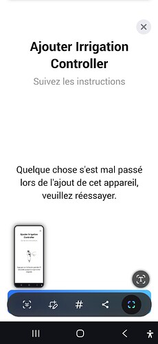

Hi @SergeP, thanks for the quick reaction ! It does not work. The device is detected by the application while installing but then I receive an error and the installation fails.
I’m surprized because it is a Royal Gardineer engine buyed at Pearl. I made an interview of the device from the developer athom site and I’m a bit surprized that the device does not seem to have any capabilities…. Here the interview of the device:

I get this when installing

Thanks for your support. I found what’s wrong: my device does not support the cluster number 6, used basically for onOff features but implements a 61184 cluster known as Tuya cluster.
Thanks to the Tuya Homey app, I succeed to developp a small application to make it works correctly.
As your app supports official Royal Gardineer device, I can give you my sourcecode if you want to integrate it as a new device + driver in your app.
