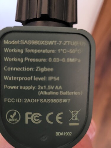

Hi SoPhos, My SasWell devices arrived today. I used your App to include one of them into Homey. It came up as a “generic” Zigbee device with no control options. This is a picture of the info on the device. I also saw that it can be added to the Toya but I am not sure how that will integrate with Homey. Thought I would check with you first. Thank you for your help.
Take care,
Bill

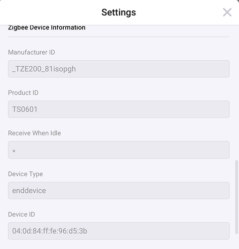

Thought this might help as well…
Hi Bill_Hartmann,
I’ve just added your device ID to Homey Royal Gardineer App.
Can you try new test App and tell me if it’s Ok with your device ?
Regards,
SoPhos

Hi SoPhos,
They both work like a champ! Thank you very much.
