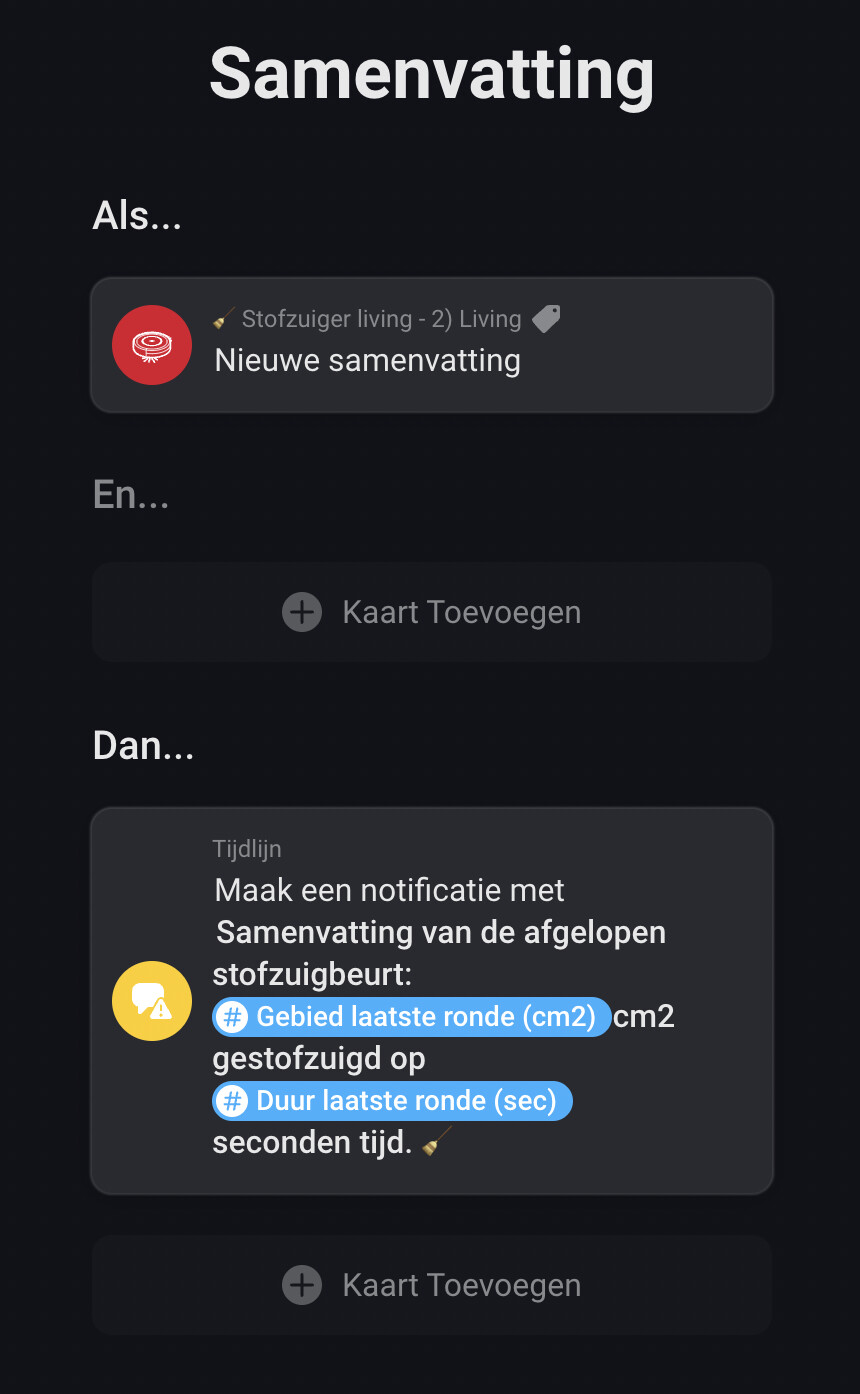

Mini issue I’ve discovered after some more testing: the flow below does not seem to do anything for my S6 Pure, even after a couple of times cleaning.
I can see all my cleaning history in the Xiaomi app so not a big problem, just thought you’d like to know :wink: .
I’m getting a lot of errors on flows triggered that he can’t find, but couldn’t find the source of it. This could be it. I’ll do some testing and error logging on it and fix it. Thanks for letting me know!

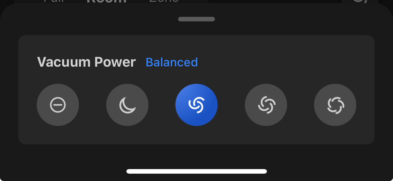

I think I found another small bug.
The above flow card does not seem to work for me at all.
Whatever I select in Homey, the Roborock does give the little ping to confirm something has changed (so it’s doing something?), but it always stays on “balanced” in the Xiaomi app for me (and I can hear the Roborock only changes when I use the app to change vacuum power).
Not a big deal for me because I just leave it at maximum most of the time, but just so you know there seems to be a problem with vacuum power selection for my model (S6 Pure).
