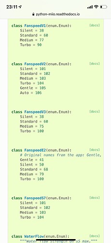

The problem with Set vaccum power is that it ping but there is no change in power.
Set water intensity do work fine. It ping and the water intensity is changed. I can check this in the Xiaomi Home app.
Did you not enable custom mode in the app? This is a option were you can choose which room will be cleaned on XX power mode. This overrides the settings. Just checkin’ …
I’m currently searching github for answers.
There seem to be differences in vacuum mode and the different models. Strange part is that I am currently using the V1, which works on my S7 :thinking:
Searching further… Trying to link the right list to the right device!
Edit:
Found it :slight_smile: I will change this tomorrow!
