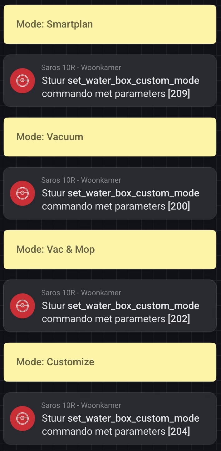

I found the following information for the Roborock Saros 10R that allows switching between cleaning modes.
One odd thing I noticed during testing: when the robot is in “Smartplan” mode and you try to switch directly to “Vac & Mop”, it doesn’t respond correctly. You first have to set it to “Customize”, and from there you can switch to “Vac & Mop”.
Would it be possible to integrate this into the app, maybe as a flow card with a dropdown menu so users can easily choose the desired mode?
Hey,
For sure!
I’ve registered issue #65 for this.
I’m first focussing now on getting the newer devices (B01 protocol - which are not supported right now) available in the app, and at the same time working to get the local connectivity working for the newer devices (L01 protocol).
After that I’ll do some improvements to the modes, you did a great research here which helps me out to correctly implement this.

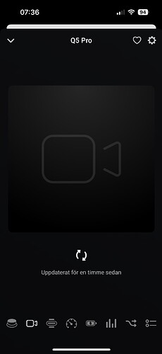

Since it’s in Swedish, I’ll try to clarify the device property I mean. The property updates to Yes whenever cleaning is ongoing, but the flowcard still seems to read it as No.
Diagonistics ID: bcc81c51-0b82-4b2a-b44c-c1a98d6df567
Cleaning was manually stopped at around 12:16. My flow should have triggered at around 11:55 when I arrived home and the robot was still cleaning.
I forgot to mention that my robot is an Roborock Q5 Pro.

Hey,
Could you elaborate more on the issue itself?
From the diagnostics report, the UI should show that cleaning is no longer active. From your message I don’t really see that, I don’t know if the screenshot when the cleaning was already stopped or not?
However, what I do see is that the app did a crash due to memory issues.
What is your Homey model? Typically on the older models, or models where there are many apps installed, we run into these issues. This is because the drawing of the map requires quite a lot of memory. For users in this scenario, currently the only option is to disable the map.
