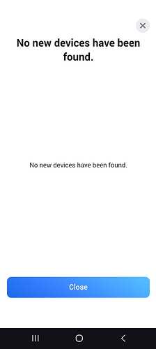

Its great that there’s a roborock app for homey!, but when i logged in with my id and password for cloud, the app doesn’t see my roborock; no new devices found. I use v2.2.1
I have an Roborock Q10PF, and its registered in the roborock app for android.
Hello guys,
@R.S_Kok
I suspect that this a newer device which uses a newer protocol. I’ve read some stuff about this on the Python library. I’ve added extremely experimental support for this new protocol. I cannot test this, so it might work, it might not work.

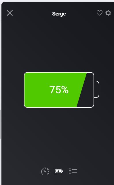

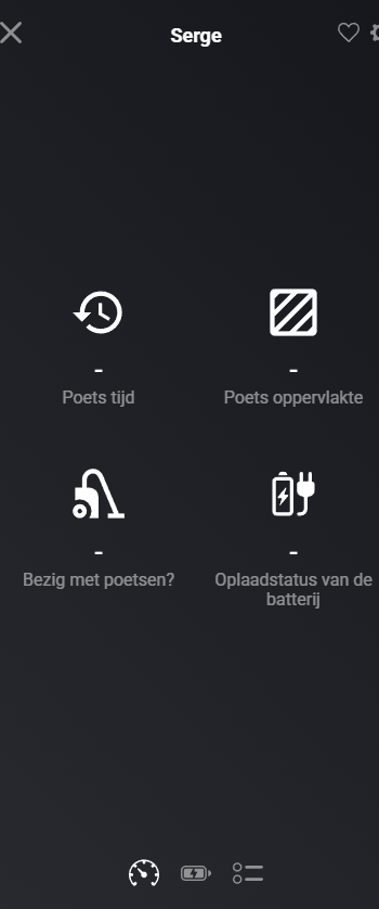

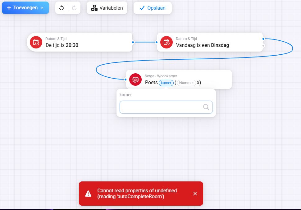

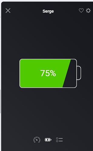

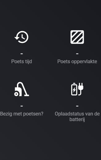

Thanks for the quick response. The roborock is now cleaning and i can see the battery status, but the other status is not visible in the Homey app. The Flow cards are giving me an error. The language in the Roborock app is set to English, and in Homey it’s Dutch. Could this cause a conflict?
Hey,
Please submit a diagnostics report after you get the error, that might give me some clues.
Kind regards,
Kenny

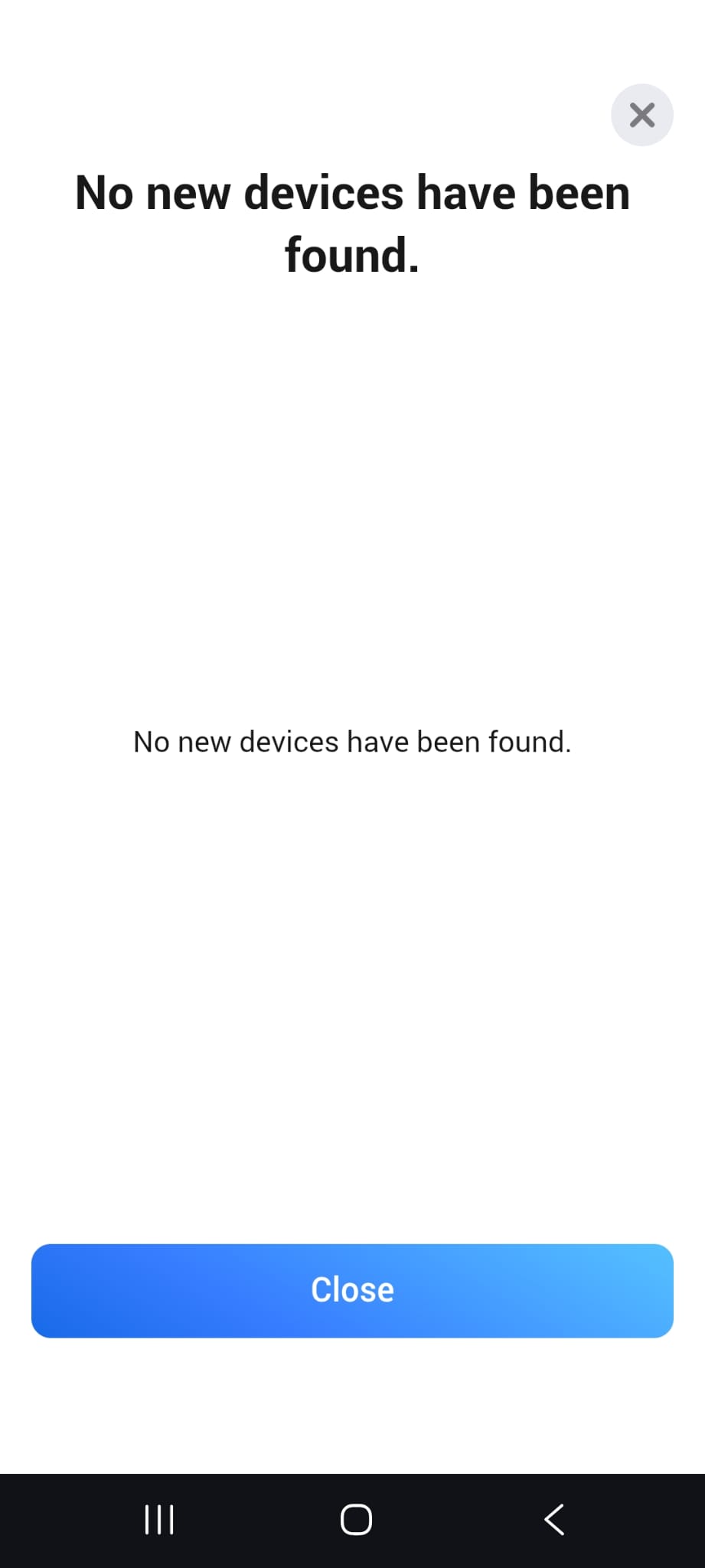

Hello, I just purchased the (Roborock Q7 M5+ Robot Vacuum and Mop, Upgraded from Q5 Max+) and have tried to add it to my Homey Pro, but I haven’t been able to.
Is this version supported?
Or, am I doing something wrong?
I get a “No new devices have been found” message when I try to add it. I downloaded and installed the Roborock official app and added the vaccum through there (not a third-party app). My Homey Pro is connected via ethernet and when I connected the vaccum it was with 2.4Ghz.
Here’s the link to the vaccum if useful.
https://www.amazon.com/dp/B0DWX69JVG
Thank you in advance!
