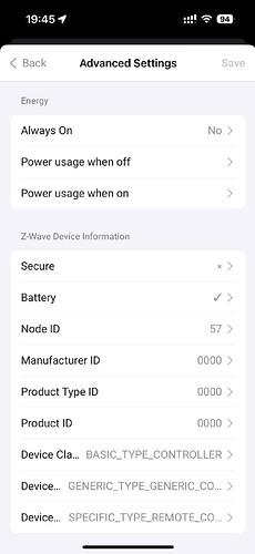

No you don’t, the other’s issue that the device doesn’t include at all, in your case it does include, the ID just has changed as the device has received an update (either hardware or software) (hence “no app was found”), which means this new ID needs to be added into the app.
Perhaps you can share the IDs so the developer can look into including it into the app. (you can find the ID’s in the device’s advanced settings, 2 types are needed: Product Type ID & Product ID)
@Caseda
The ID’s are 0
Hmm, that sounds more like a bad/corrupt device, i’ve never seen a Z-Wave device with 0000 as ID on all IDs.
Edit: Might be why it failed for the other users though, so not 100% definitive it being a device issue.
I’m going to ring them tomorrow
Unfortunately exactly the same issue here.
After the message "Could not find an installed app for this device. It has been added as ‘Unknown Z-Wave Device’, the Manufacturer ID, Product Type ID and Product ID are all 0000.
Now, are these IDs 0000 because of the device reporting them, or is this the result because it was added as an ‘Unknown Z-Wave Device’?

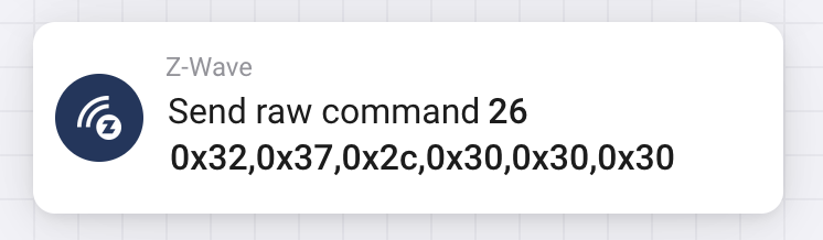

Hi, how to set IR code learning - command ID, and how to use them ?
I have a ZXT-120 AC Extender, used before the product ZIPATO ZIPABOX 2 for control.
There I have entered command ID, i.e. programmed IR learning for the commands that are available for my AC but also to turn on and off the TV in my ZXT-120 AC Extender.
Easy to access from my ZIPAXOX 2, but now end of life and hopefully I can get this working on my new Homey Pro 2023
How do I access these learned IR commands in Homey?
(the old from ZIPAXOX 2 is still in ZXT-120 AC Extender memory)
If I want to reprogram, run IR learning, how do I do that?
Have to learn about new IR codes with the ZXT-120 AC Extender, but can’t get that to work either.
Tried sending command directly to ZXT-120 AC Extender via
But no response…
Anyone who knows
