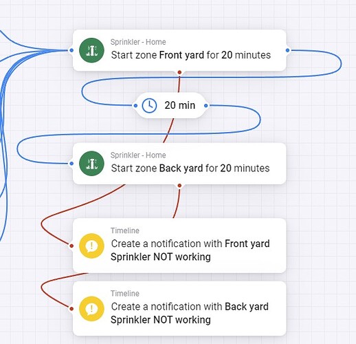

Hello, I need a advice on how to make my flow work.
I don’t know what is everyone flow look like but this is the easiest that I can think of.
I have 2 zone ( Front yard and Back yard )
I do not have any PGM set on Rainbird app just pure Homey pro.
every time the flow start it alway skip Front yard zone and go stright to Back yard zone.
and the timeline doesn’t say anything.
both of table and test version does the same thing.
I guess I could add a delay?
please help
Thank you

What does ‘for 20 minutes’ mean here? Should it stop after 20 minutes?
What happens if you remove it?
You’d should add
When…
-sprinkler front yard started
Then…
-delay of 20 minutes
Then…
-stop sprinkler front yard
Same for back yard
You should also test if the front yard part works at all?
When…
Flow is started
Then…
-start sprinkler front yard

------I found the problem. it’s the flow card.----- ( Queue )
( Start zone Front yard for 20 minutes )
it should run Front yard first for 20minutes before trigger
( Start zone Back yard for 20 minutes )
right now it just trigger Front yard then stop right away then start Back yard.
it shoud put Zone 1,2,3 in the queue.
meaning run zone 1 till done for set time, then zone 2 till done for set time, then zone 3 till done for set time,
right now it just jump to zone 3 without wait for zone 1,2 to run for set time.
this is just a quick fix that work for now. just add a delay card.
but I think it should work without that delay card.
idk I could be wrong. the flow card said ( Start zone for minutes )
YW!

Ah, now I see. You assume the card to ‘activate’ it’s output after 20 minutes.
It doesn’t. It ‘activates’ it’s output right after the command (start sprinkler) has completed.
Note:
A big downside of the onboard delays:
they don’t survive a Homey restart, and a power outage.
I use only use them for short delays (couple of minutrs max.); for longer delays I use Chronograph timers, they continue after a restart / power outage.
