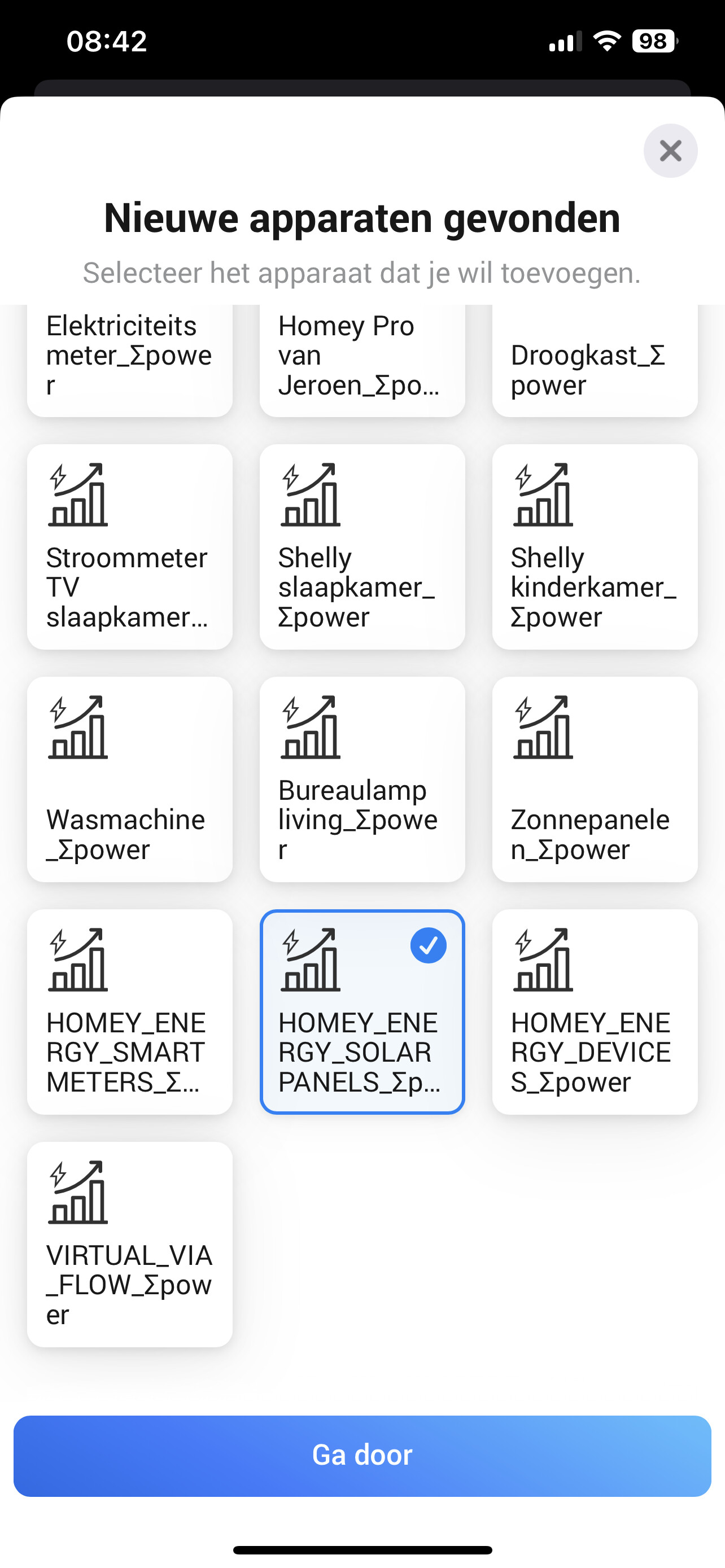

I couldn’t get the virtual device to work, still no idea why, I must be doing something wrong?
But then I found this:
And it seems to measure the total panel yield correctly without the need to create a virtual device.
But weirdly it doesn’t have a daily reset enabled. Is it measuring watt’s in this case? Or an aggregated Homey solar yield of some kind? Because the measuring in the “zonnepanelen” app is still only showing daily values.
So I don’t know how it works right now, but it works :nerd_face:.

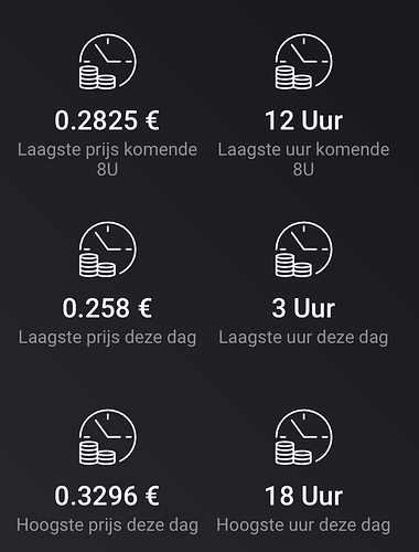

I have a strange question, I read everything and couldn’t find it. I’m trying to learn a bit slowly now and would like to know the following: How I can see what the lowest energy price is today (I have a dynamic contract) and I would like to receive a message at 9:00 am with the lowest price information ( and what time that is).
I’m sure it’s very easy to make, but I can’t figure it out. And would still like to learn it. (sorry, I have to ask in English)
You can create a flow that triggers at 9am. As THEN card you send a message to yourself. In the message you put the tags for lowest price and lowest hour. Use the search bar to find the tags by name from the (very) long list.
I took a look but there are still many options that I can set. Which one should I use then? There are so many choices in lowest price that I can choose and if I am right here, what amounts should I enter? I don’t just find lower price and lowest hour. I’ll probably do something really stupid now.
Look, I do have this list of my Solar Plan information:
