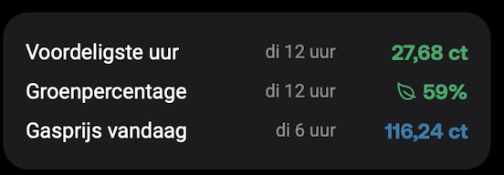

But I have a little problem to get the correct price. It have to be (today 07-11) 116,24 cent. And when I put the information to get it, in the app, I get an other price. I don’t know what I do wrong.
I do something wrong, but I don’t know what.
Zonneplan Price: 1,1624 euro
My price in the app: 1,644 euro
This is the correct price today:
Scherm­afbeelding 2023-11-07 om 08.46.57
This is what I have put in the App:
This is how I get it:
The fixed markup you enter in PBTH must have BTW included.
So, according to the info you provided:
(0,48980 + 0,08) x 1,21 = 0,689458
Thank you @Gruijter
When I do that, I get 1.1792 and it is 1.1624 (from Zonneplan)
I use TTF_EGSI, is this correct?
Zonneplan gas:
Komt precies op 1.1624 uit.
As far as I can see from the source code the fetching of new data happens at a random point of time once an hour. And when the prices are available on the APIs (entsoe/nordpool) potentially could also have a bit of an delay. So after 15:00 you probably should always have tomorrows prices, but before that its’s not guaranteed to have been updated/published yet.
Het bedrag dat jij geeft @Torch1969, klopt. Het bedrag, dat ik van @Gruijter kreeg klopt niet. Daar zat de fout in. Bedankt voor de hulp!

This is because @Gruijter calculated 21% btw over this amount, but because this 21% is also a separate factor, that way it is calculated twice. Nonetheless great you have the right amount now :grinning:.
I based this on the info supplied by Ed:
In PBTH the % entered in advanced settings is not calculated over the fixed amount. So BTW should be added manually before entering the fixed markup.
But it seems the info from Zonneplan is incorrect. Doesnt matter. Torch got the right number.
