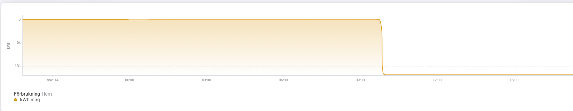

So all the sudden today my energy consumtion jumped to negative.
It was counting just fine for daily production but around 10:00 today it went negative
Any ideas?
Nothing was changed or done, and my smartmeter is showing correct data.

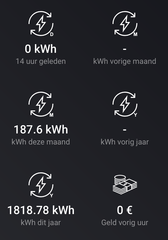

I have the same issue. al lot of values are negative.
Any way to set them to the right values before midnight?

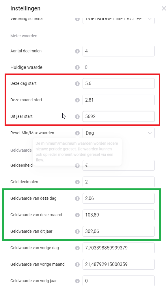

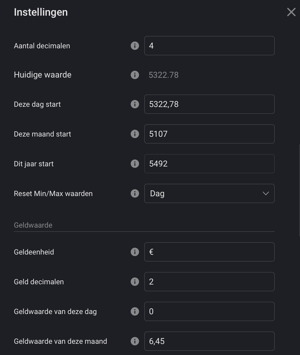

You can manually set the start kWh values in the device settings.

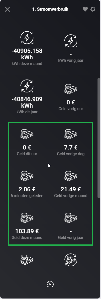

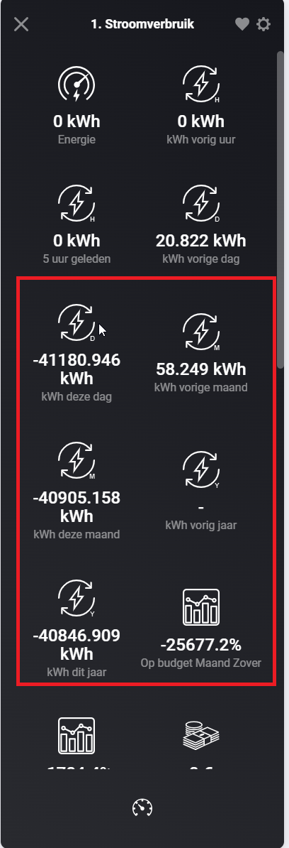

Yes but not all. kWh this day, month and year not.
Money values for this day, month and year are adjustable.
Just substract approximately 41170 to this day, month, year start.

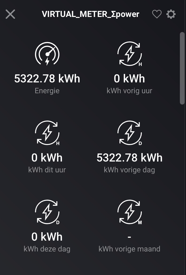

In my information it will be 0kWh - last hour, this hour, this day
I can’t see all :frowning:

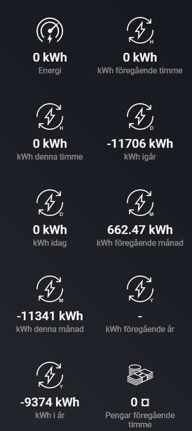

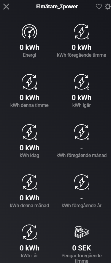

I have 3 totalizers in my setup.

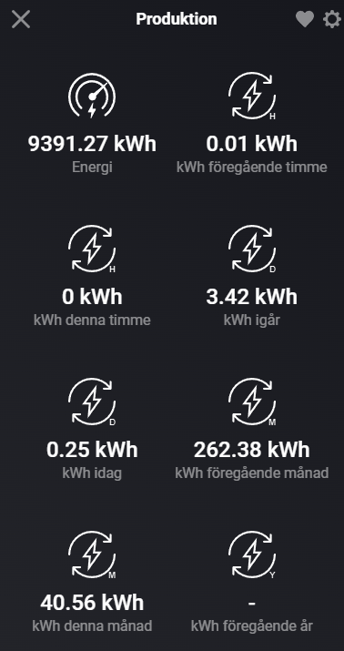

  1. Production (solar) is working.

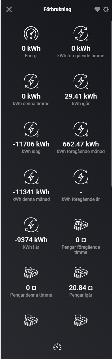

  2. Consumption negative values yesterday, not updating at all today.
  3. Consumption, added this for test yesterday, not updating at all yesterday or today.
(1)
(2)
(3)
