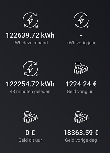

When you look at the meter_power capability that @Johan_Olsson posted, you see it is set to NULL. That is why his meter isn’t updating
I do not have this issue. @Johan_Olsson could you update the app with the test version to see if this will be removed? Ps, are you from Sweden? If so did you install the Swedish firmware?

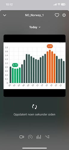

I am using the Power By The Hour app to run a water heater for 4 hours each night where the prices is lowest. I have made an Advanced flow that “kind of” work, except it can start a 2-3 hours late compared to the lowest electricity prices. Am I using the cards wrong? Or can there be a issue with time offset? Living in Norway so we are at CET.
Below is a screenshot flow, and of today’s Prices showing the lowest prices from 1am to 5 am. However my water heater started at 3 am and shut down at 7.
You trigger with a time card ‘every new hour’. However it could be that that starts a few seconds before PBTH has been able to update the prices. So try delaying the trigger with e.g. 10 seconds.
In winter, CET = UTC is + 1. So that can explain 1 hour difference.
I would just include a message in the timeline what time is passed for the lowest energy price.
Gruijter, What would be the best trigger to use? Would it be better to use “when price changed”?
That is what I use myself. That way you can be sure that the new prices have been processed.
Still showing null in test version.
Could you go to your device and sent me a picture of the result or save the output and sent it to me. I remember that the Swedish output is different.

@Gruijter I have changed the trigger to “when price changed”, and still it seems to be delayed. Last 3 days water heater has been active from 3 am to 7 am. Prices in table shows lowest prices from 2 am. I can’t see why this is not working as it should. Can there be any issue with time zone / daylight saving?
PBTH uses the timezone that your Homey is set to. When you look at the prices in the app, are they correct for this hour and the coming hours?
