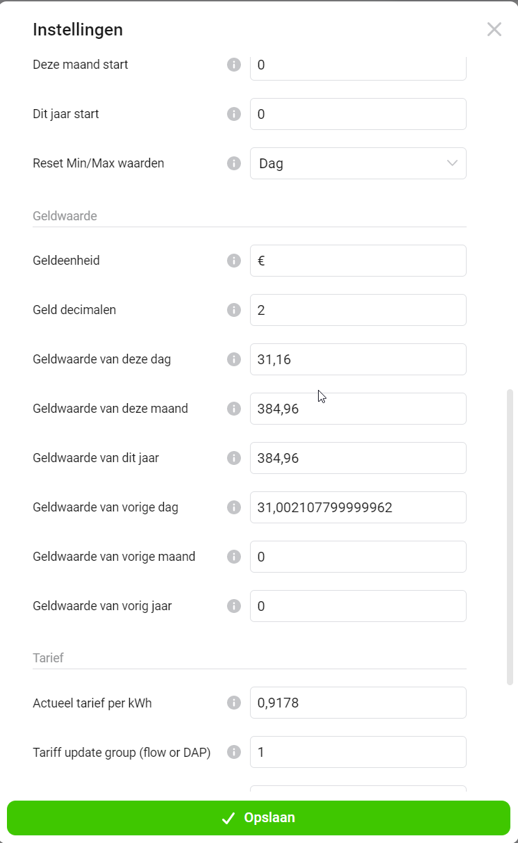

Can you post a sceenshot of the PBTH settings of that device?
Why did you enable ‘has daily reset’? Or do you really use 635kWh in a single day?
Ah no, wait: your source device is at 34kWh today. So it does indeed reset to 0 every night?
Do you indeed use around 34kWh on a day every day?
It does reset to 0 every night because I have set that option to yes.
My usage is on workdays around 16 kwh and on weekends around 20 kwh.
Is that an option in the Homewizard app? If so disable that (and also in the PBTH app) and your issues are gone.
No, not an option in Homewizard. Only in PBTH.
It only goes wrong after a restart of the PBTH or update.
