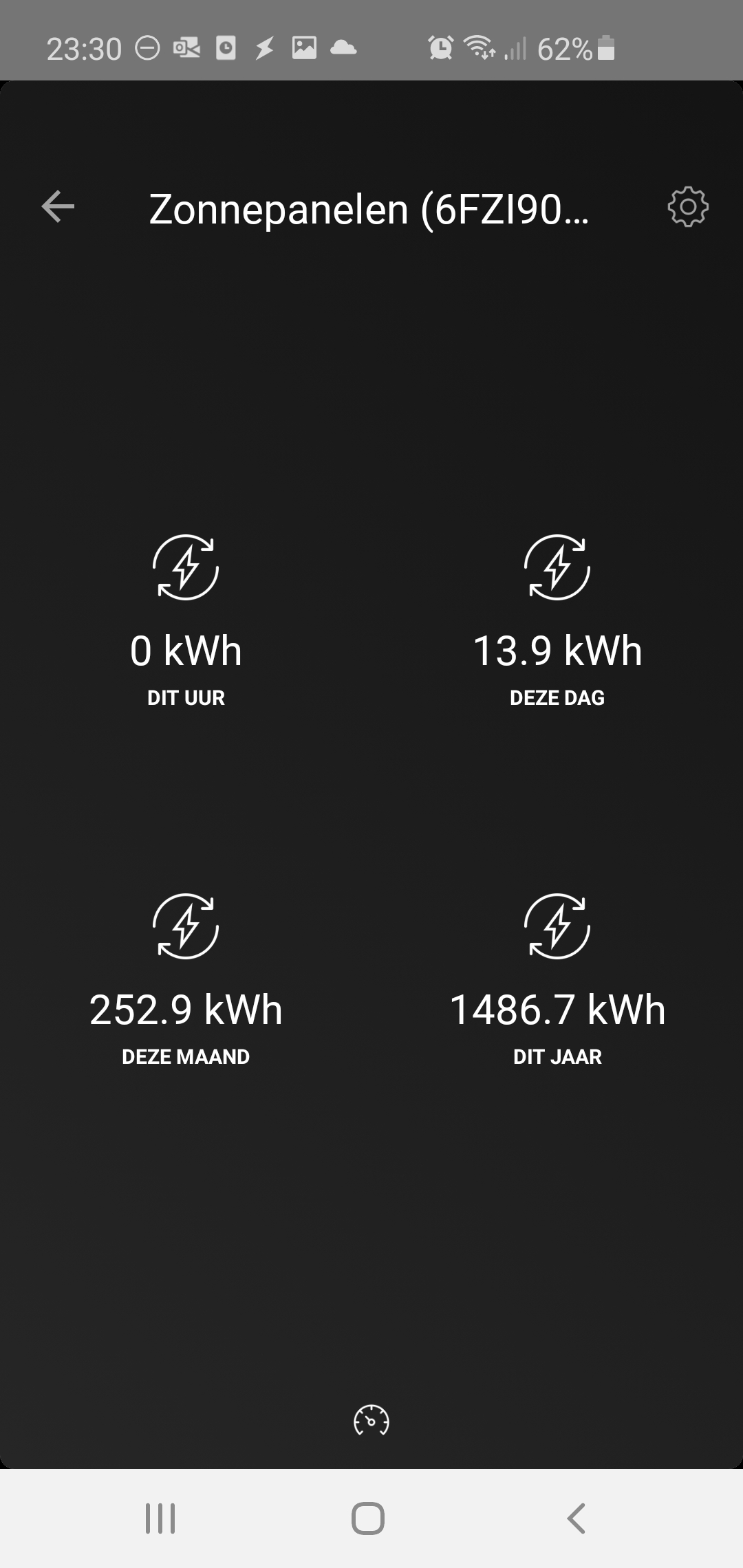

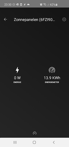

great app. But Bug in display of meter?
No update on meter but in details the correct value (solar panels): 13,9 ( correct value) vs 3 (false value) kWh.
(After restart or crash it resets the day value?
I restarted the app)
The 3 kWh is what was produced today (or since device pair if you paired today). The 13.9 is the cumulative kWh. But judging by the low cumulative number I suspect you are using the solar panel app. If so, please read the entire thread on this subject.

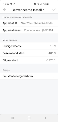

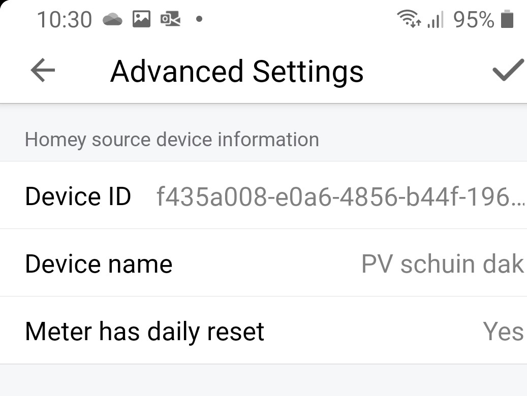

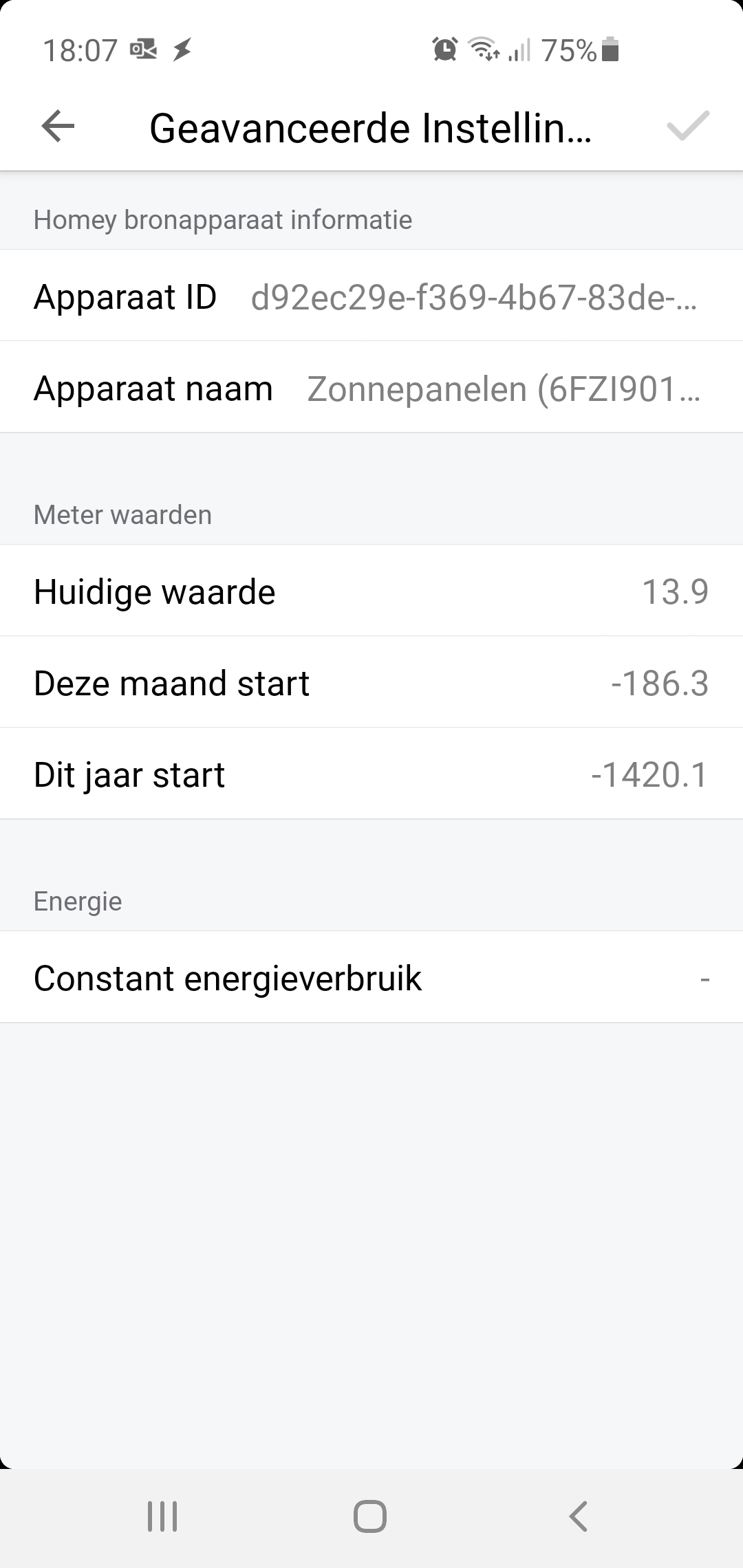

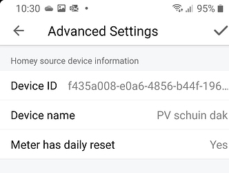

I created a test version in which you can select if the source device resets its meter to 0 every day. The Power By The Hour app will then try to make a cumulative reading by itself. This should work for the Solar Panels app.
@Diederik @VanGilles @Wolly_a Can you please test if it works correctly. I cannot test it myself since I cannot use the Solar Panels app:
Thanks for the update! :slight_smile: I’ll test it right now and will report you tomorrow
Hey Master! :wink: I think you fixed it!:slight_smile: thanks.

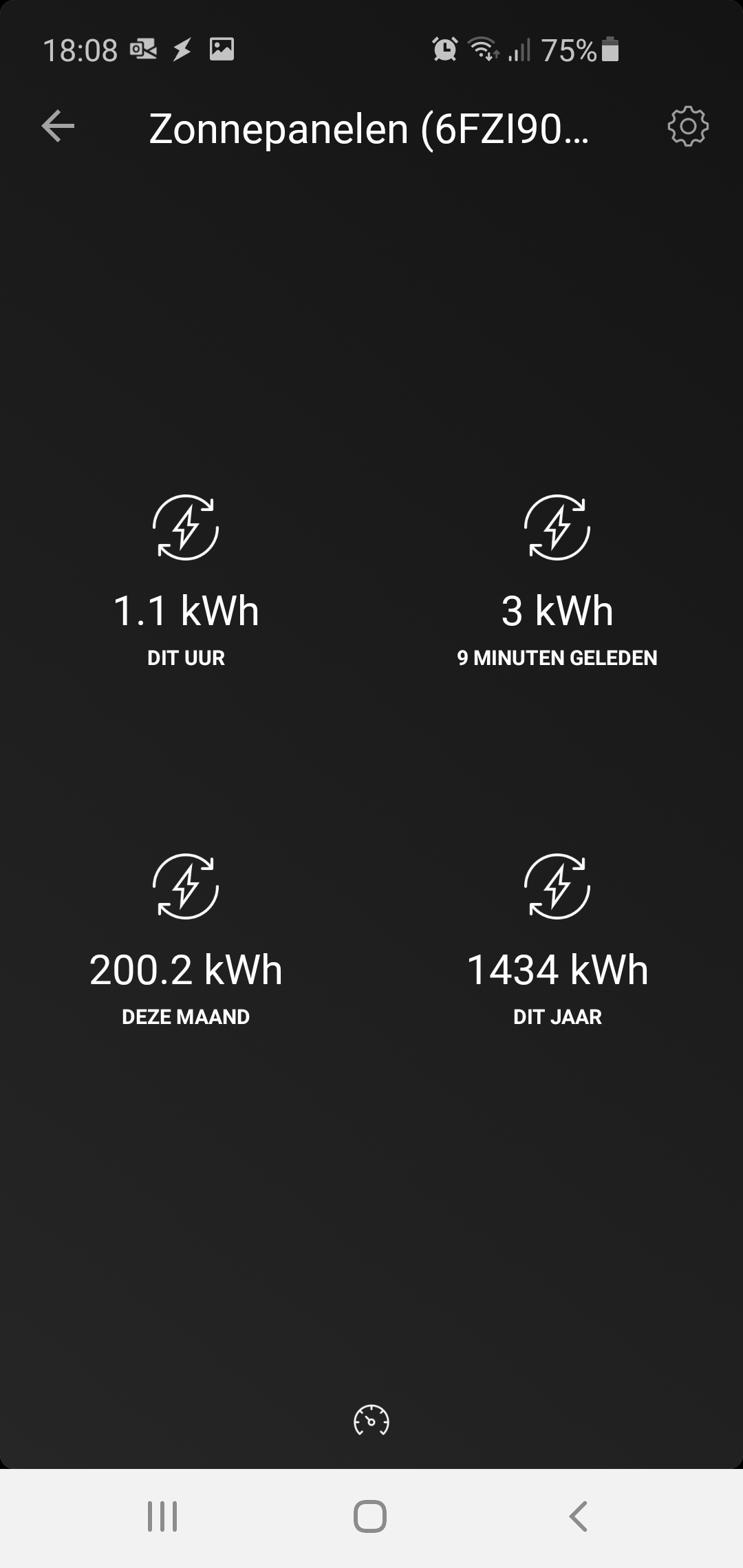

Yesterday late night sun down, inverter down:
Solar panel app:
Power by the hour app:
Today new day and inverter up and running again:

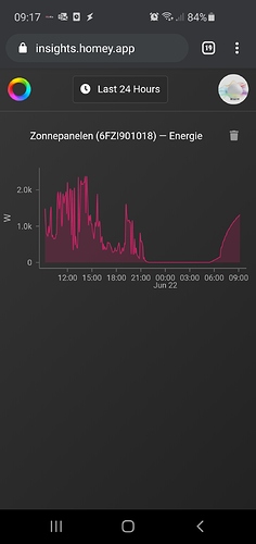

Do the Insights look o.k. around midnight?
Solar panel app insights:
As you can see, when the sun is down you see a ‘flatliner’ around 21.30 till the sun comes up again. So I think the value remains ‘0.00’ @ 0.00h.
