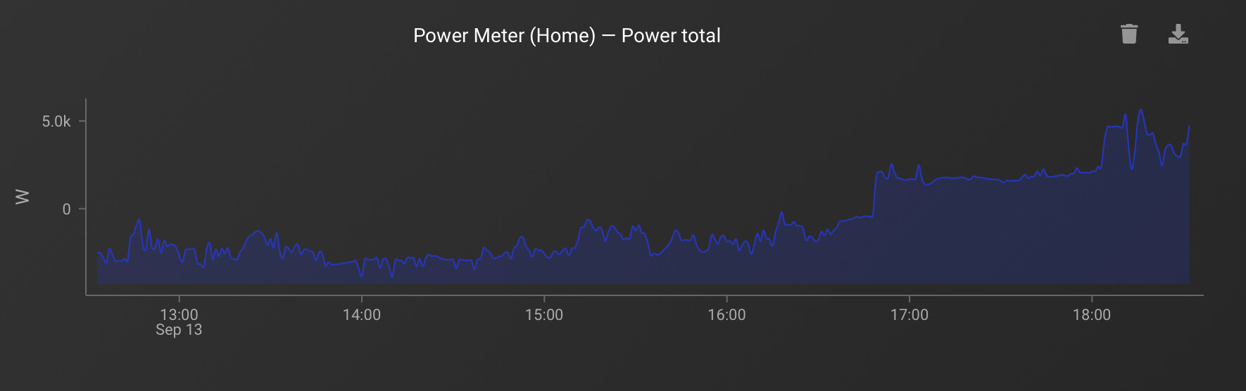

I’m using PBTH already for some time and I’m a big fan but recently my 1 phase power meter got swapped for a 3 phase one and I’m getting weird readings. My Youless is running the latest sw and the readings per phase are fine, also energy readings look fine. However my PBTH app shows negative numbers when the should be positive and positive when my solar panels are providing energy. I’ve tried a reinstall, setting the nummers correct but the readings are incorrect. Also the preset reading is not correct. Any idea what is going wrong?
Can you share screenshots of Insights graph of a day that is working incorrectly? Show the youless watts and total kWh, and the corresponding PBTH kWh of this_hour.
Thx. But actuallly I meant the Insights graphs :stuck_out_tongue_winking_eye:
From above snapshots I cannot see much wrong by the way, other then that it is a brandnew meter and the ‘this year/month start’ seems to be set to to around -30kWh ( a negative number) in PBTH. Can you check what the advanced settings are in PBTH? Did you indeed set a negative number there?

Ah I see your problem in the settings. Why did you switch on ‘has daily reset’ ?
Ehhh no idea… I want to see my usage per day…
Usage per hour/day/month/year is what PBTH delivers per default. The advanced setting for ‘source device had daily reset’ is meant for kWh meters that do not deliver a cumulative value. E.g. some solar panel meters reset to 0 every day.
But for your main smart meter you should not use that. It messes up the values as you have now experienced :kissing_heart:
